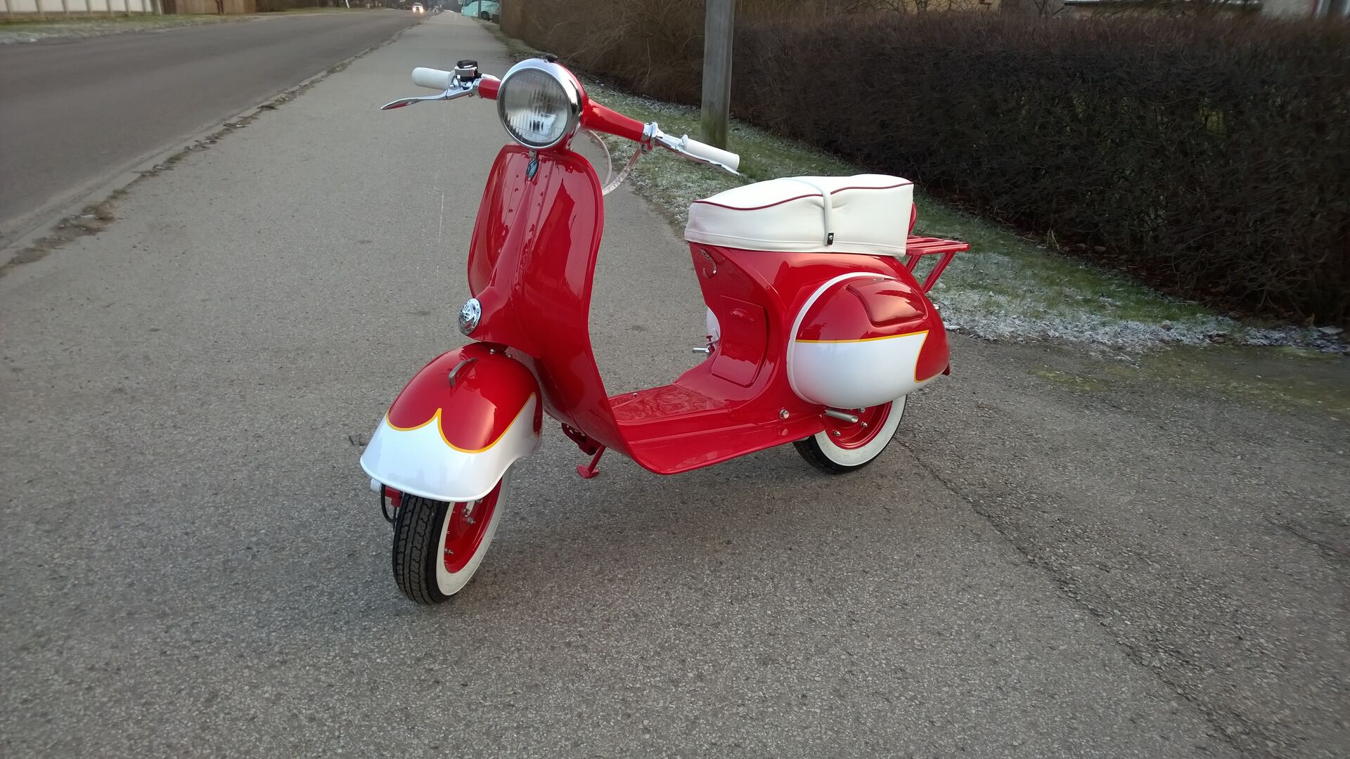

    Hallo!
    Firstly, sorry i can't speak German, but i would like to introduce my project. I live in Estonia and Vespas are really rare in my country. So we have more common Vespa copys - Vjatka. The last decade has become these scooters more and more rare.
    I will not make a long story, one picture is worth more than thousand words.

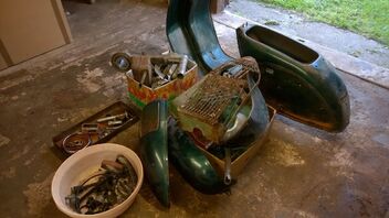

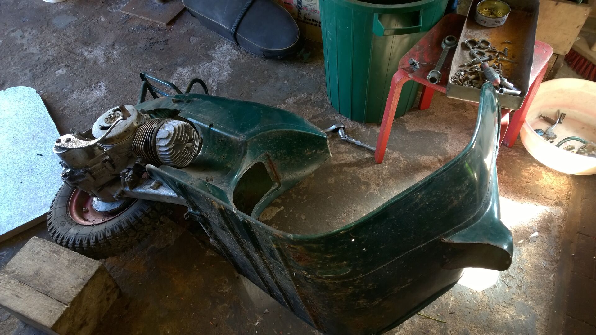

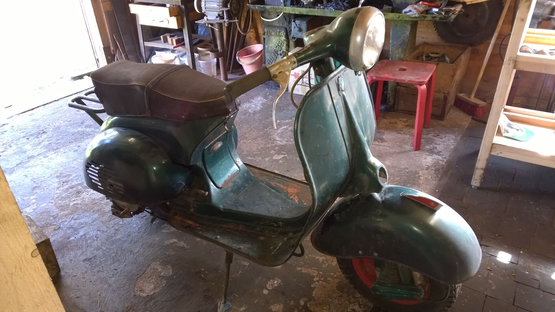

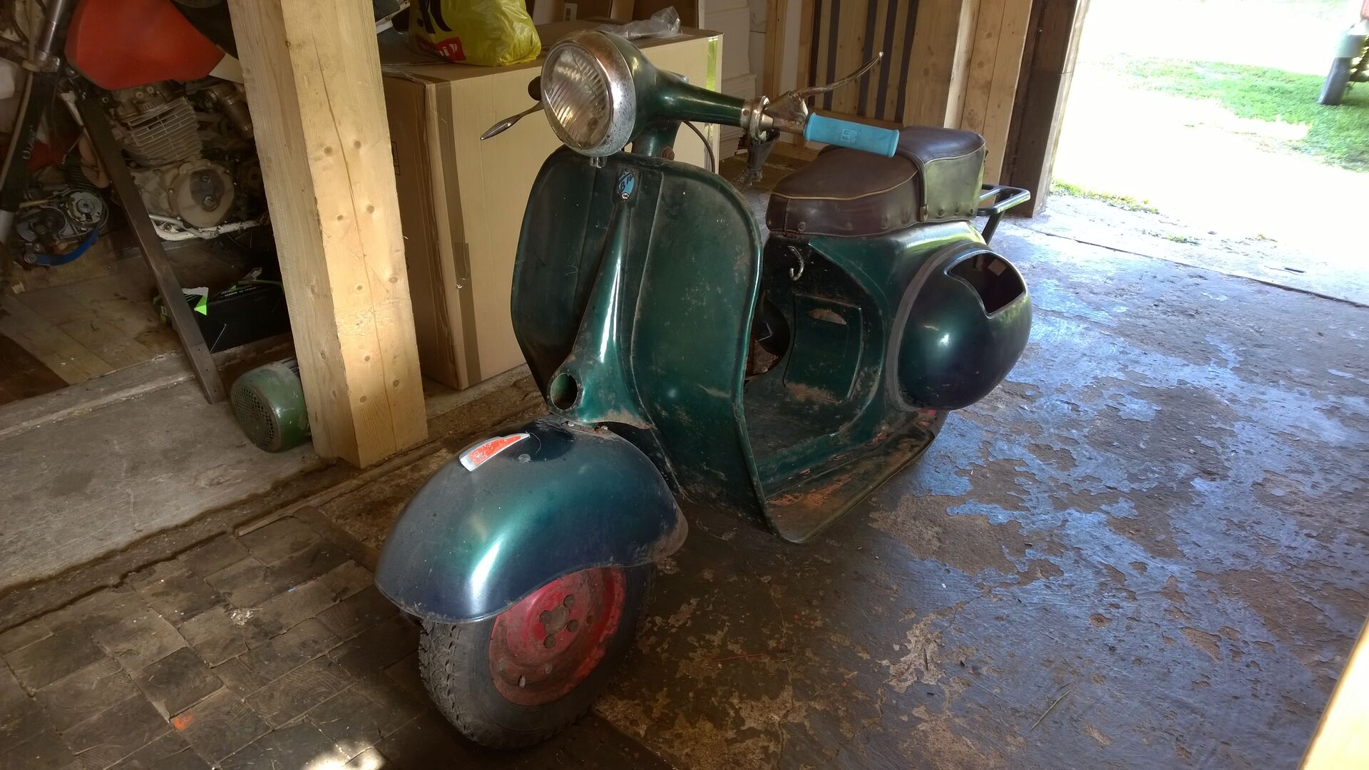

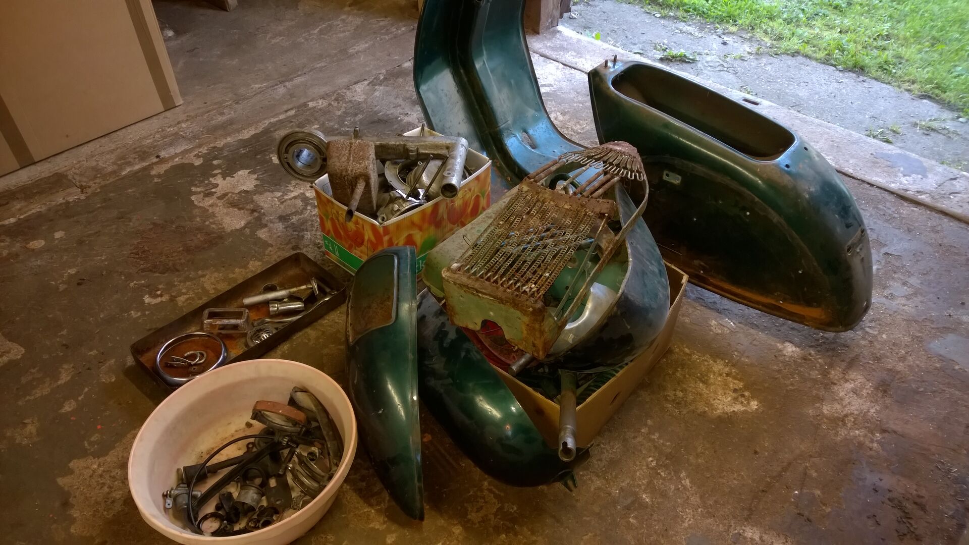

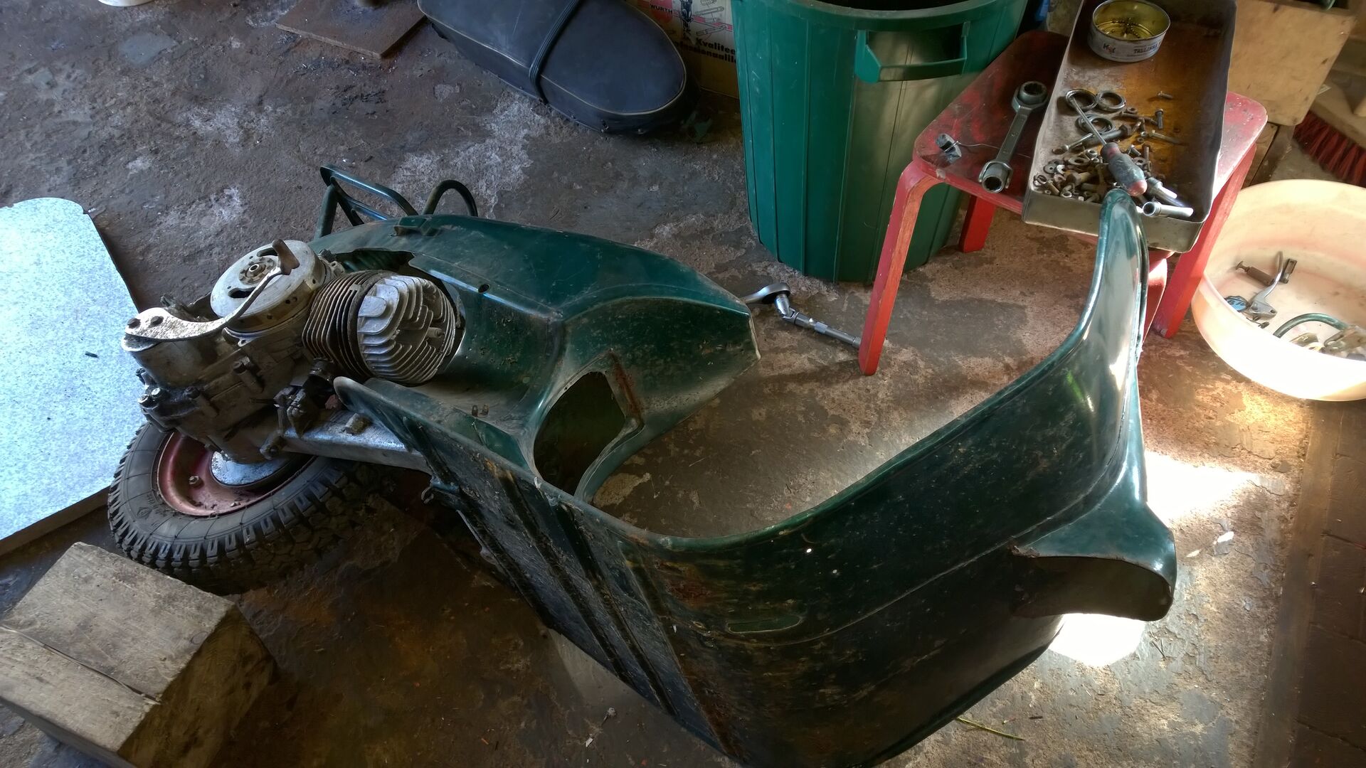

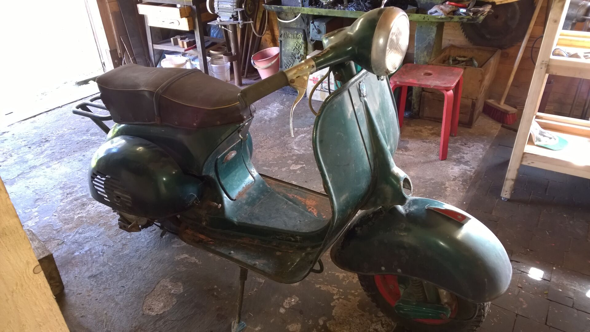

    That (s)he looked when i got it (07.09.2014).

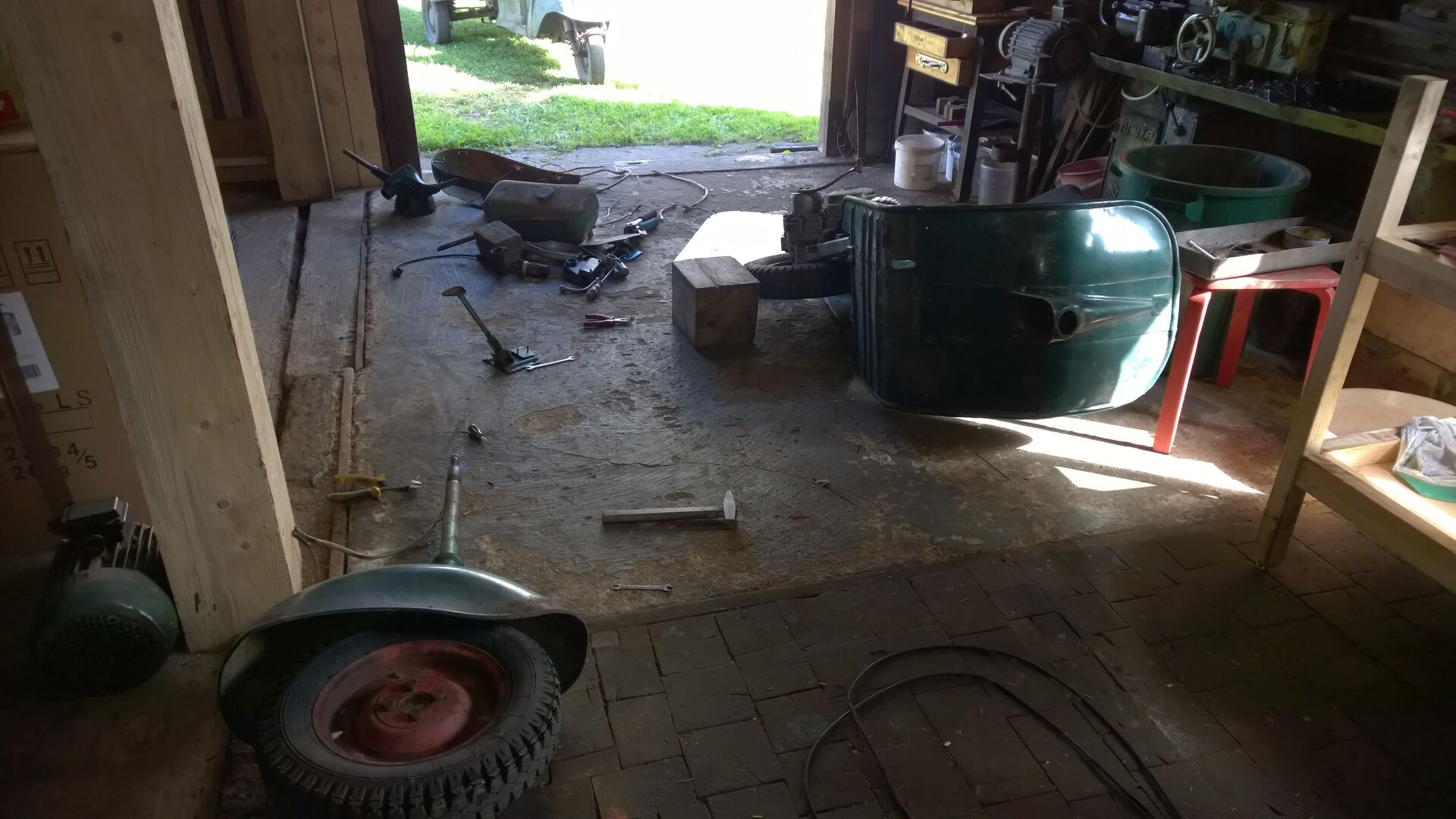

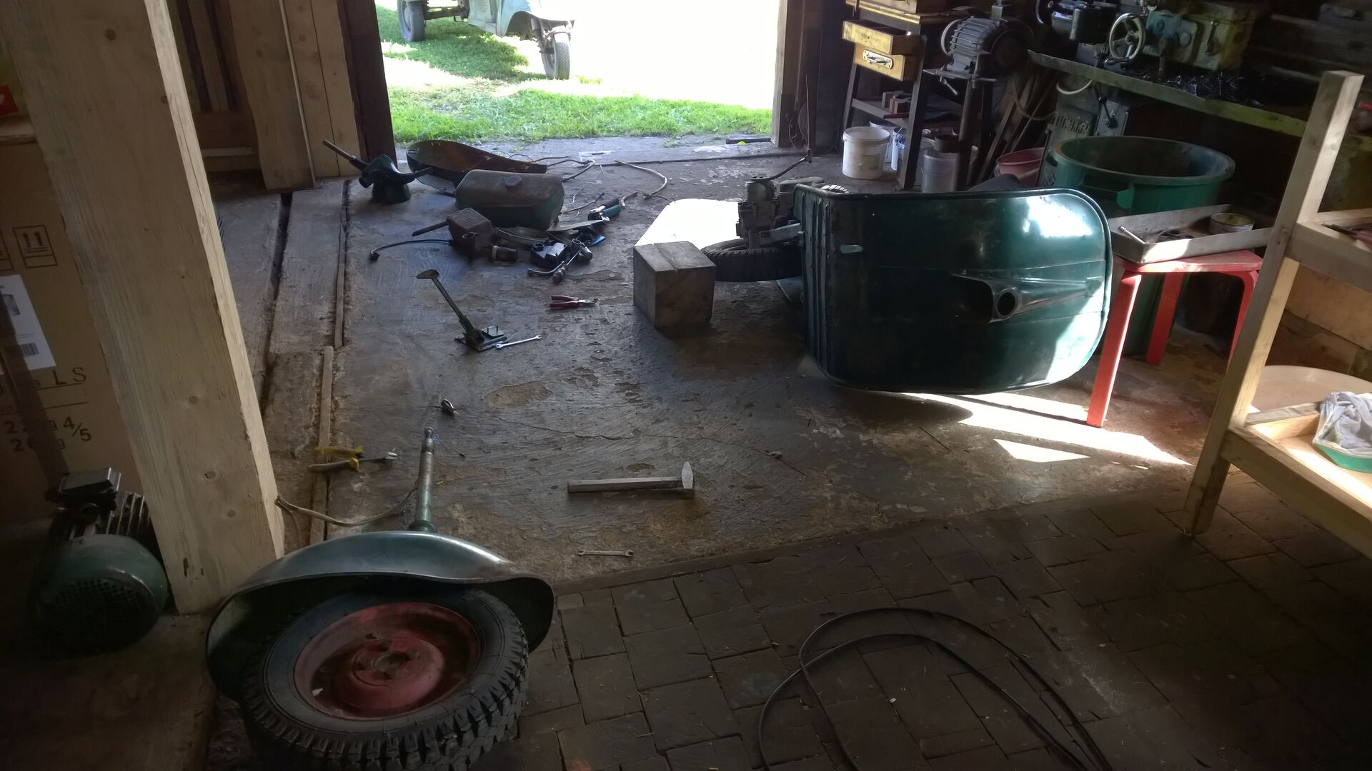

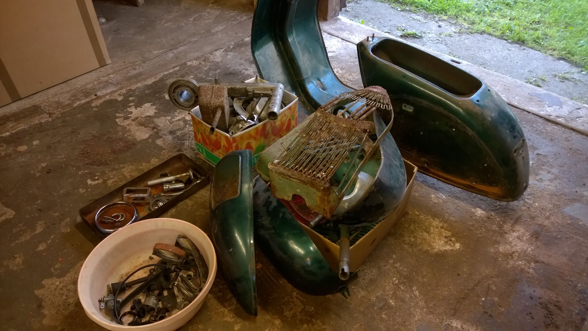

    Next day i took it into parts.

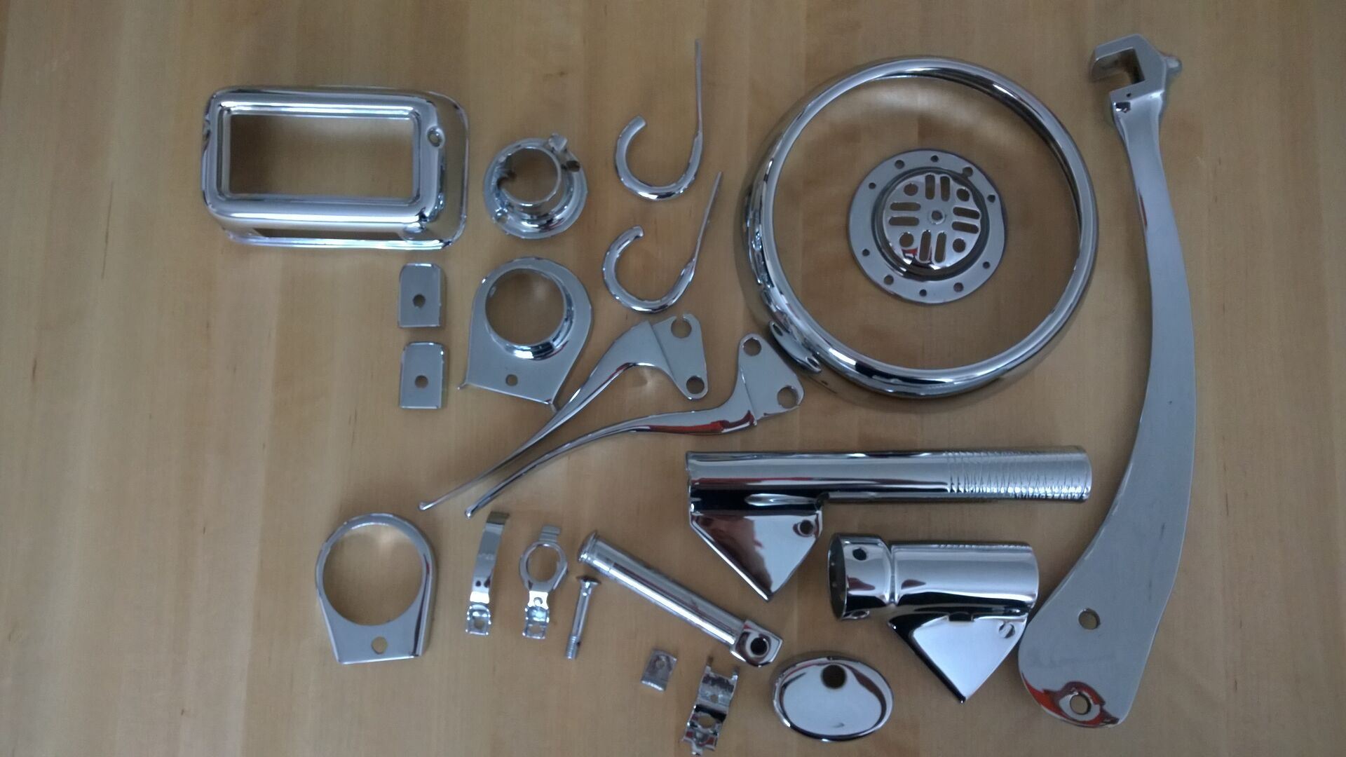

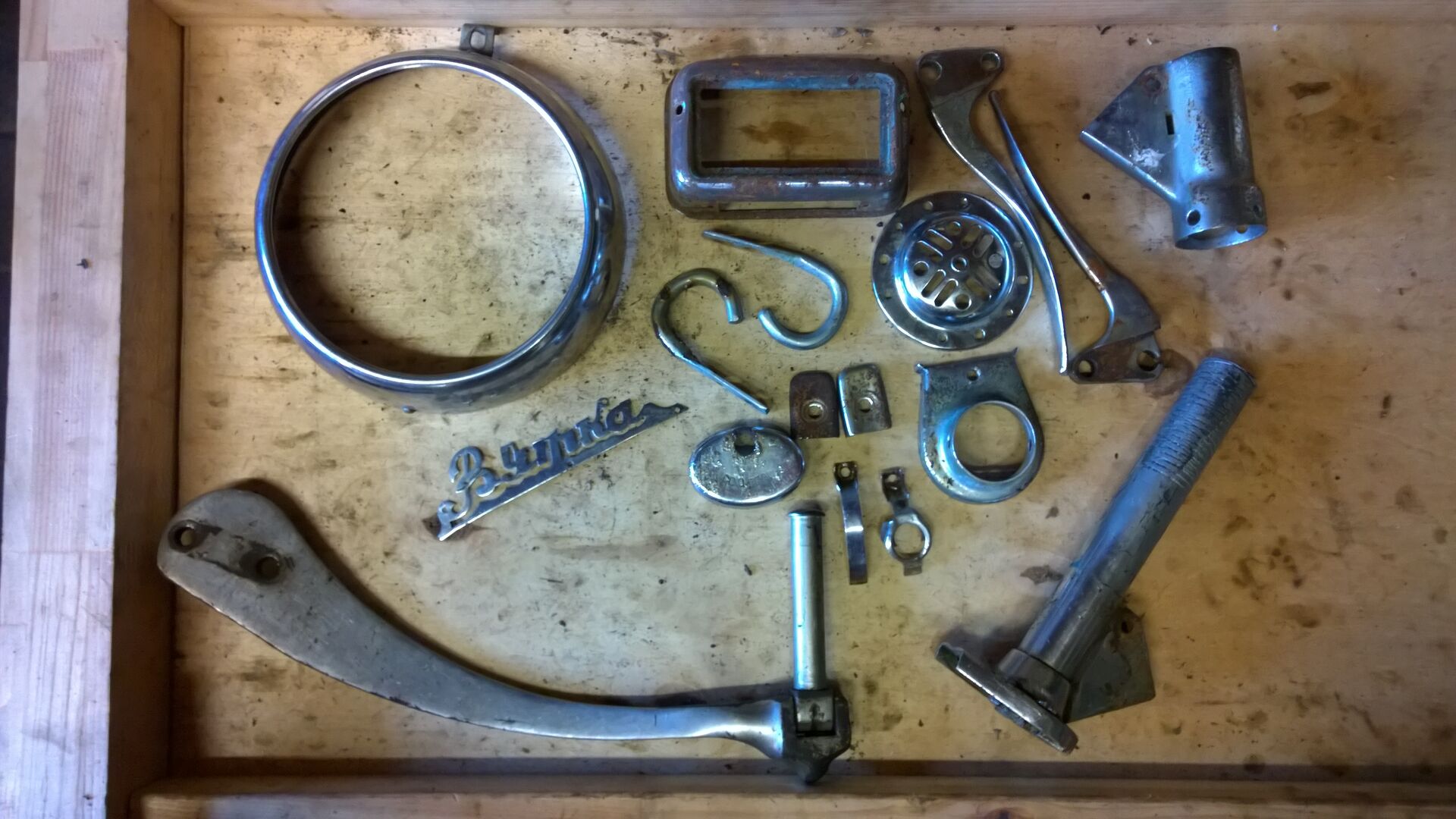

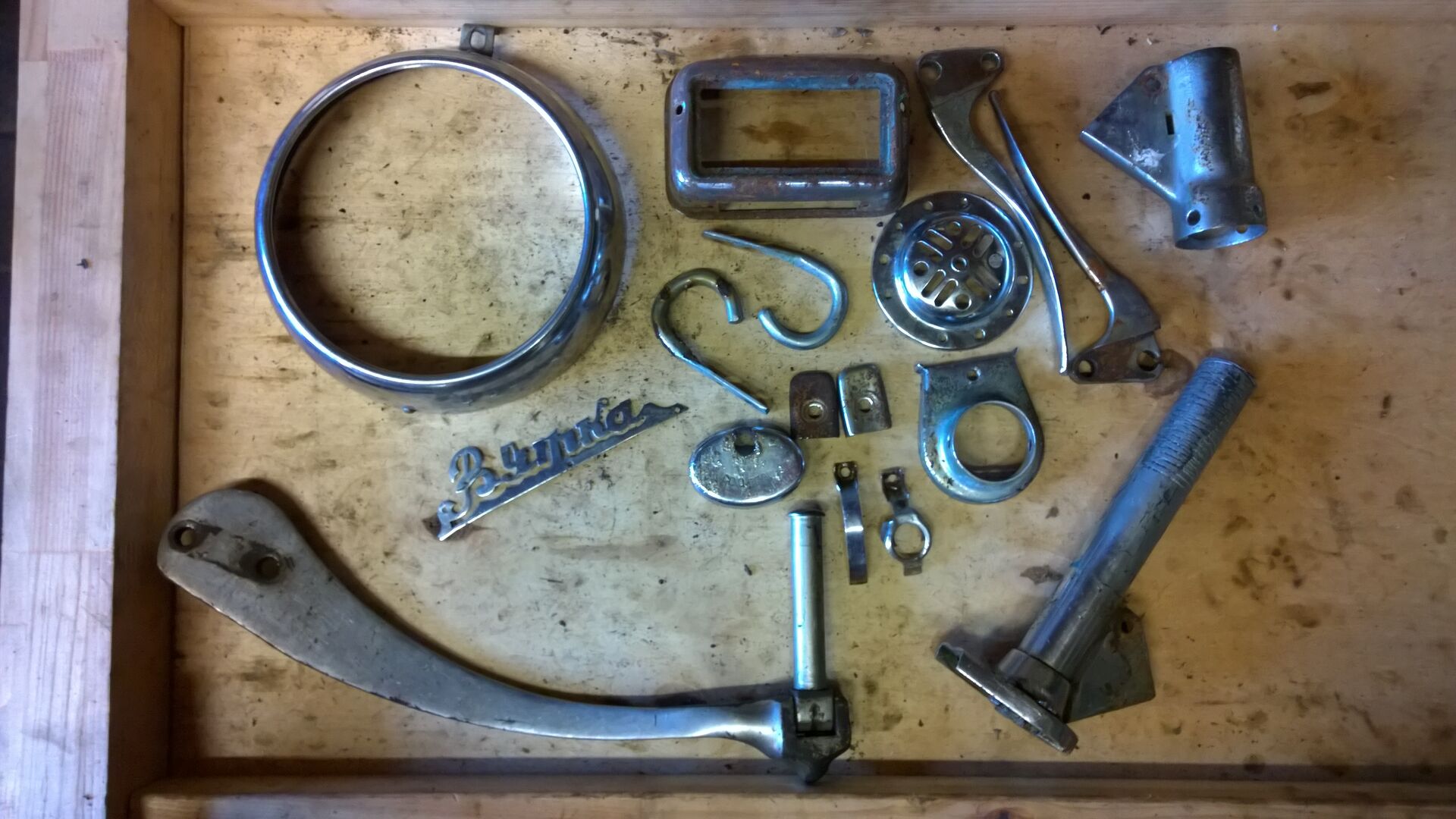

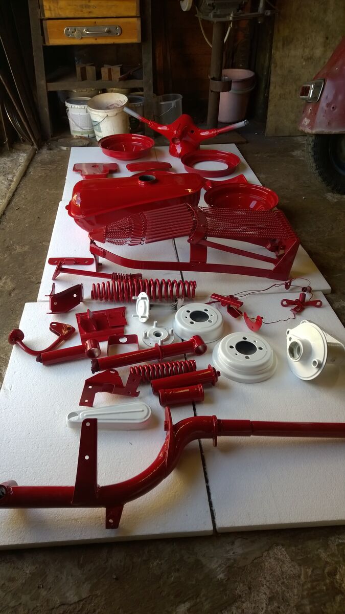

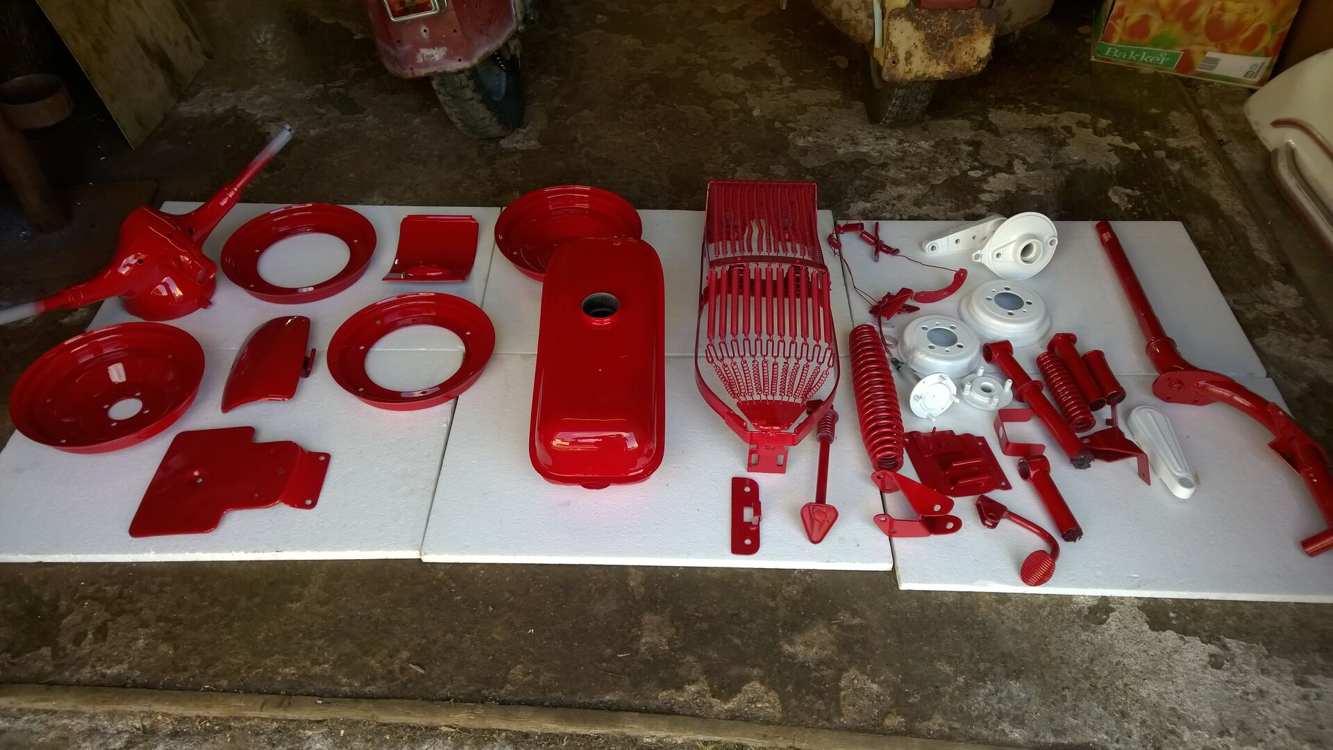

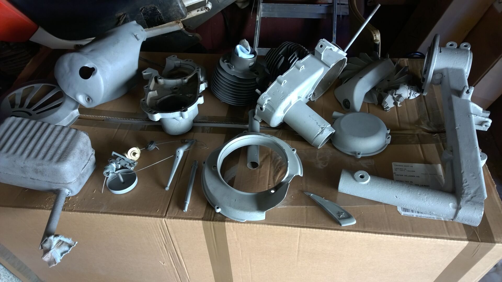

    All stuff is waiting to go to sandblasting and rechromeing.

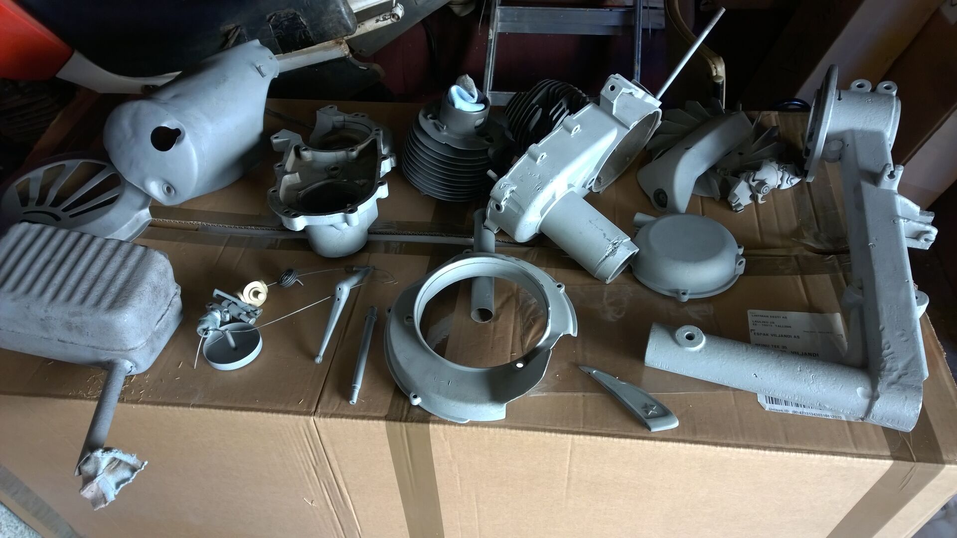

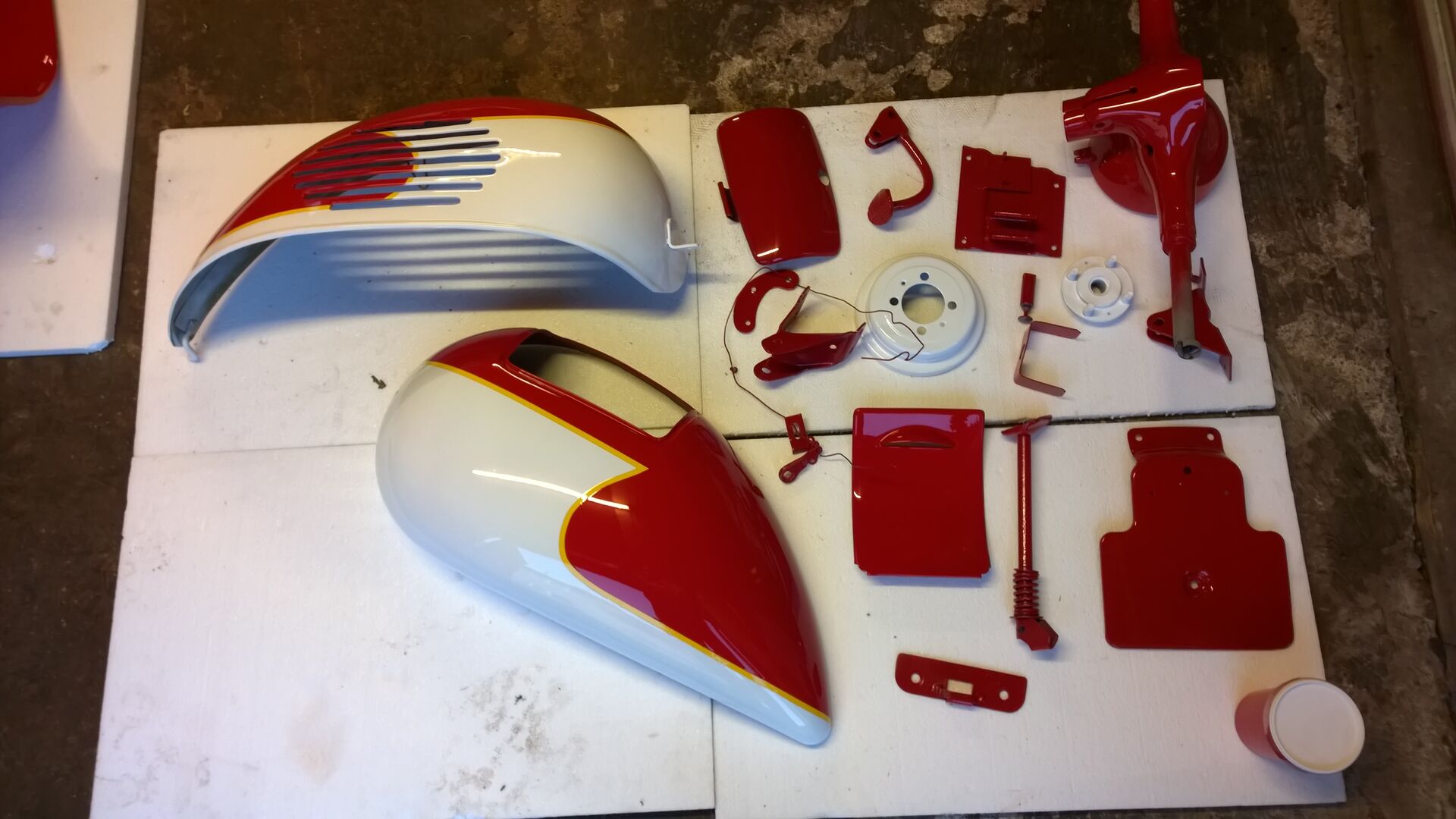

    Cleaned aluminium details.

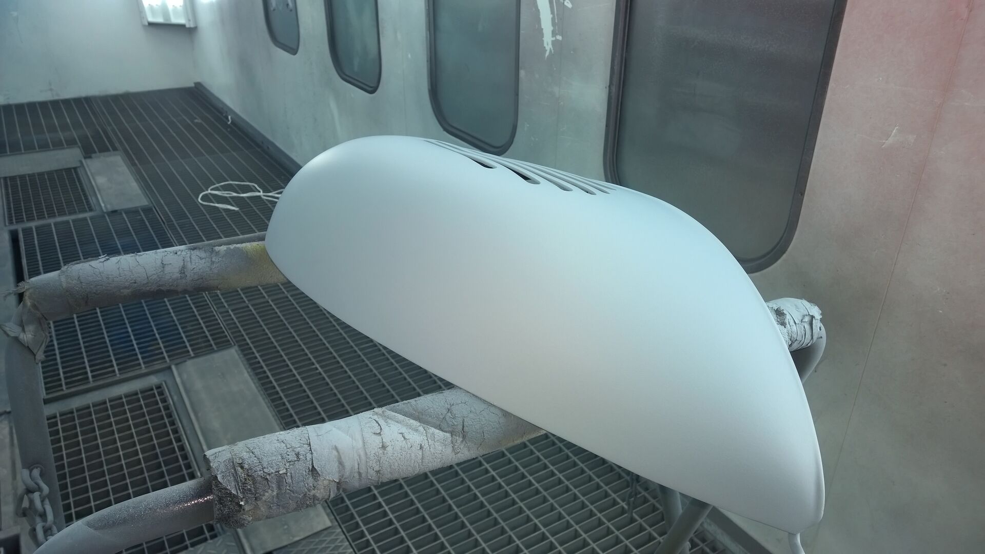

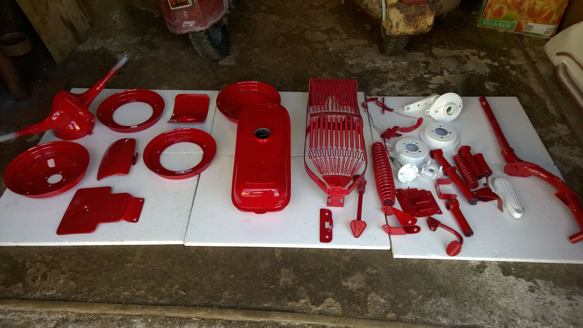

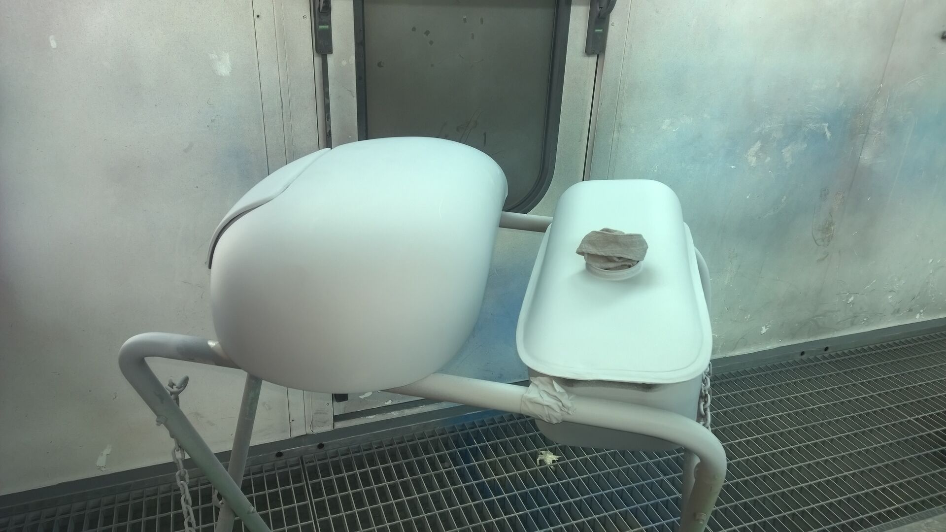

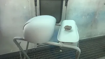

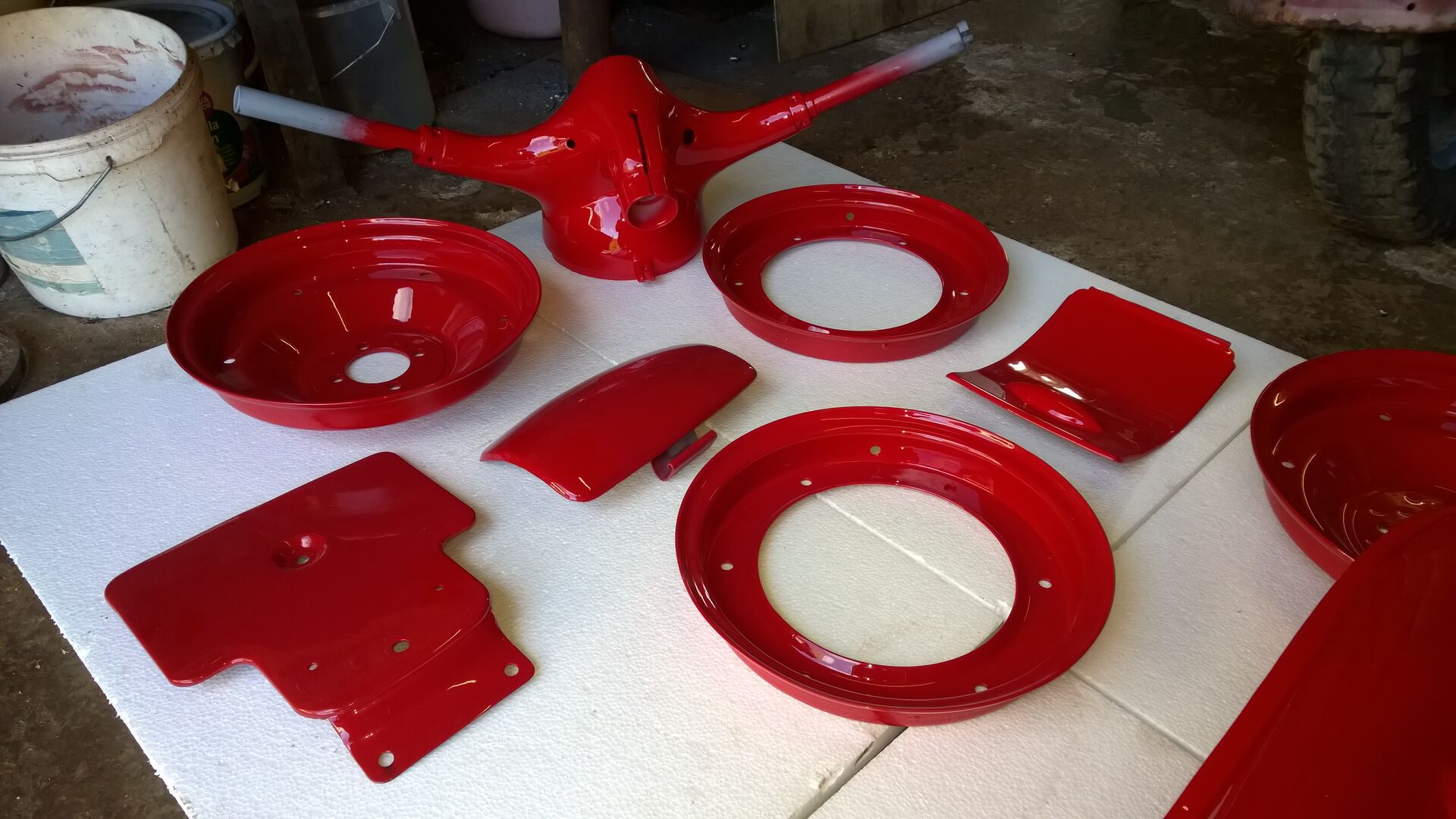

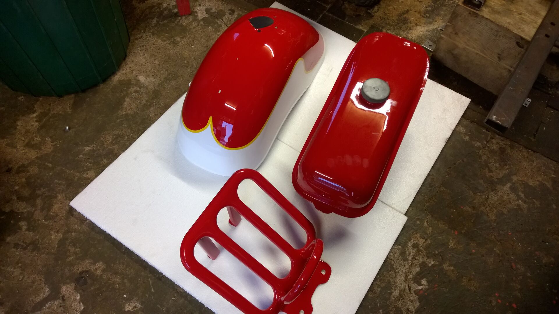

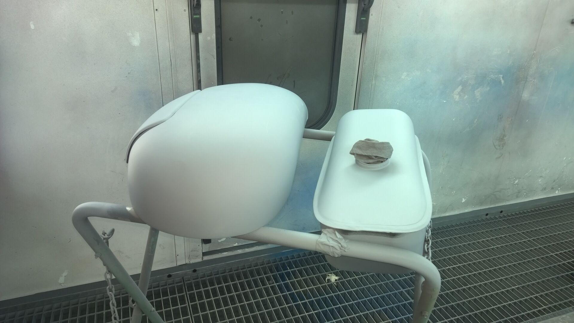

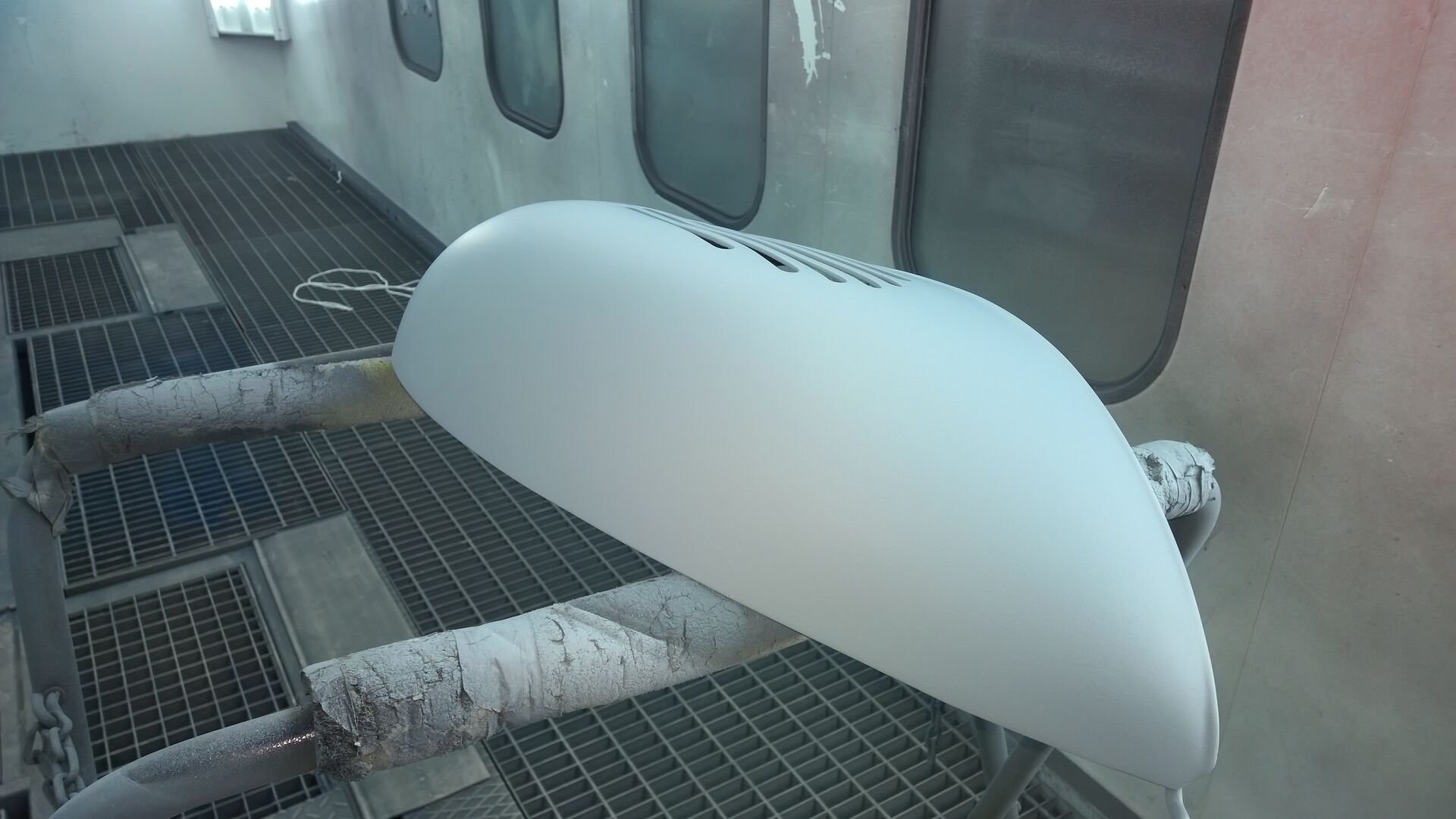

    Sandblasted details paint job.

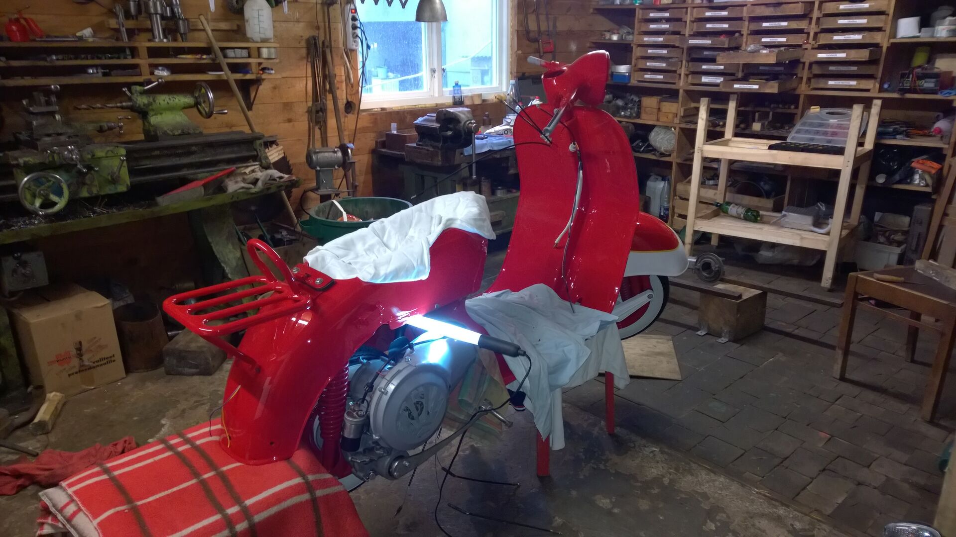

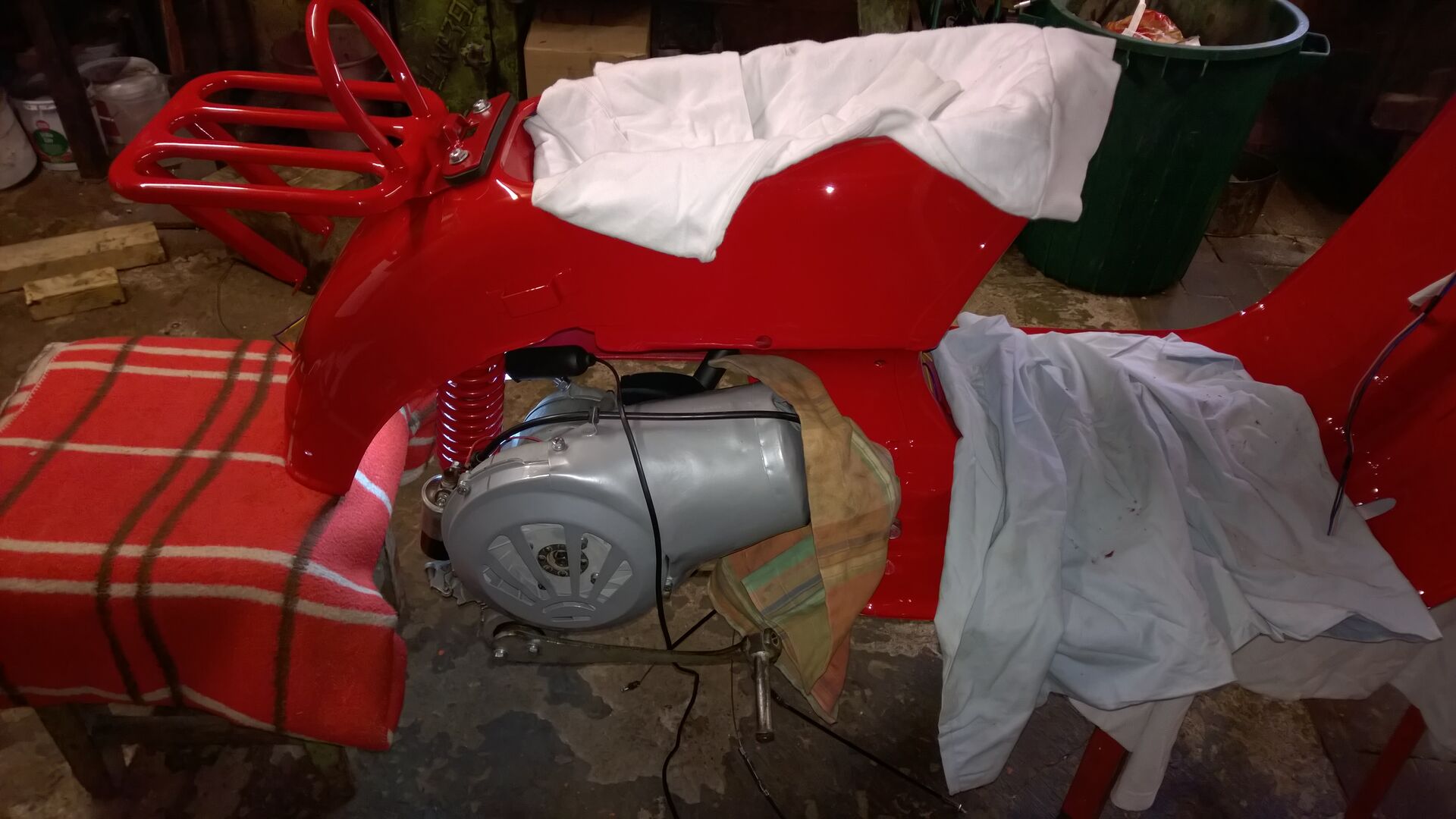

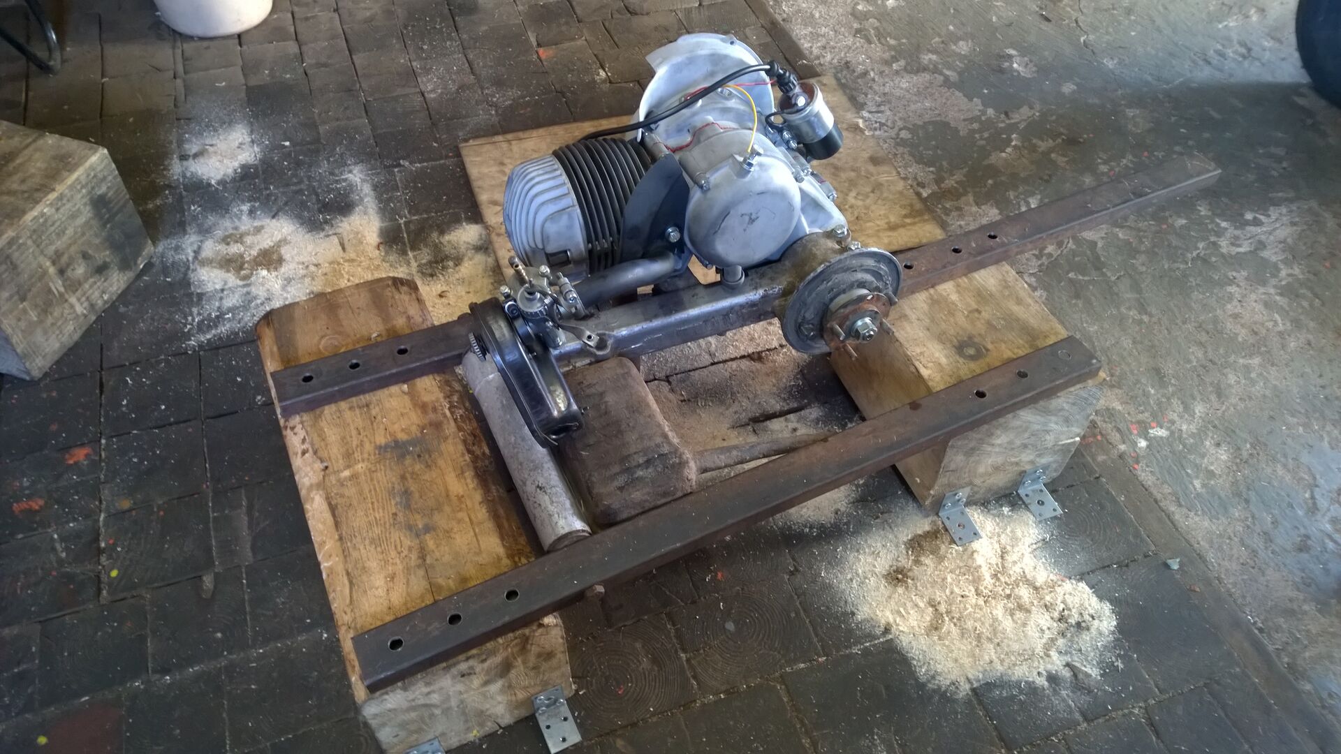

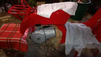

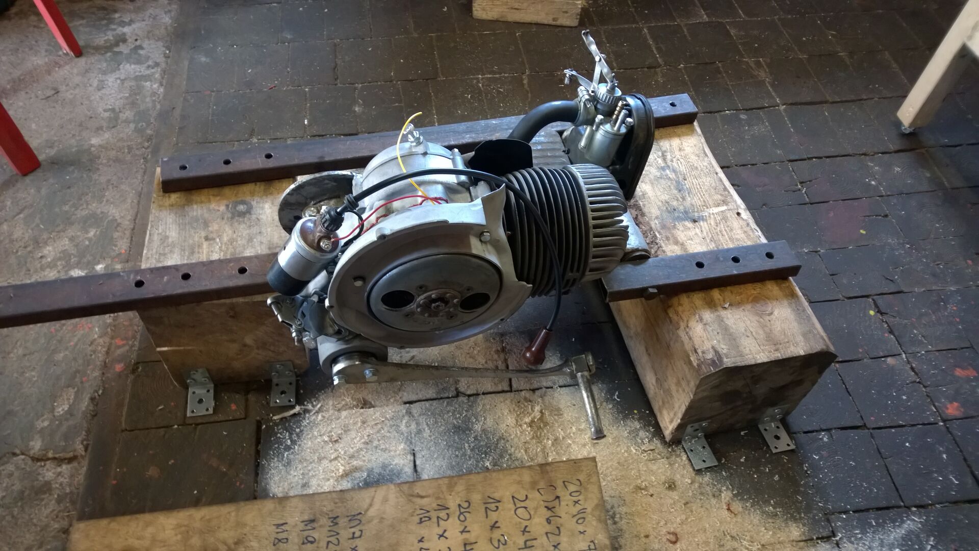

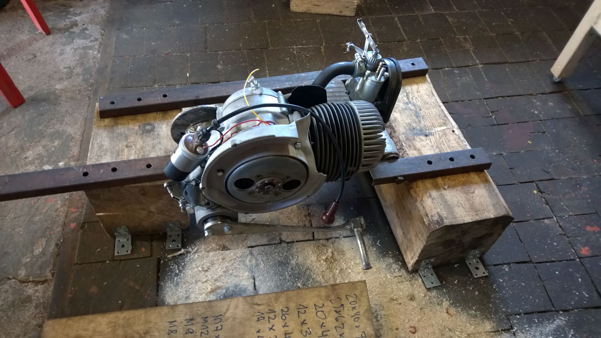

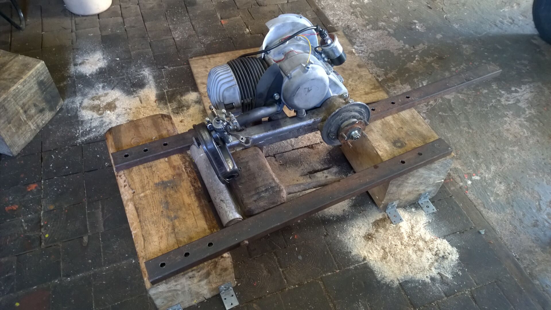

    Previously i built engine stand, where i can start engine. All bearings and oil seals are changed. Engine started for second shot. Here is video.

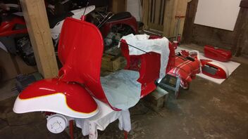

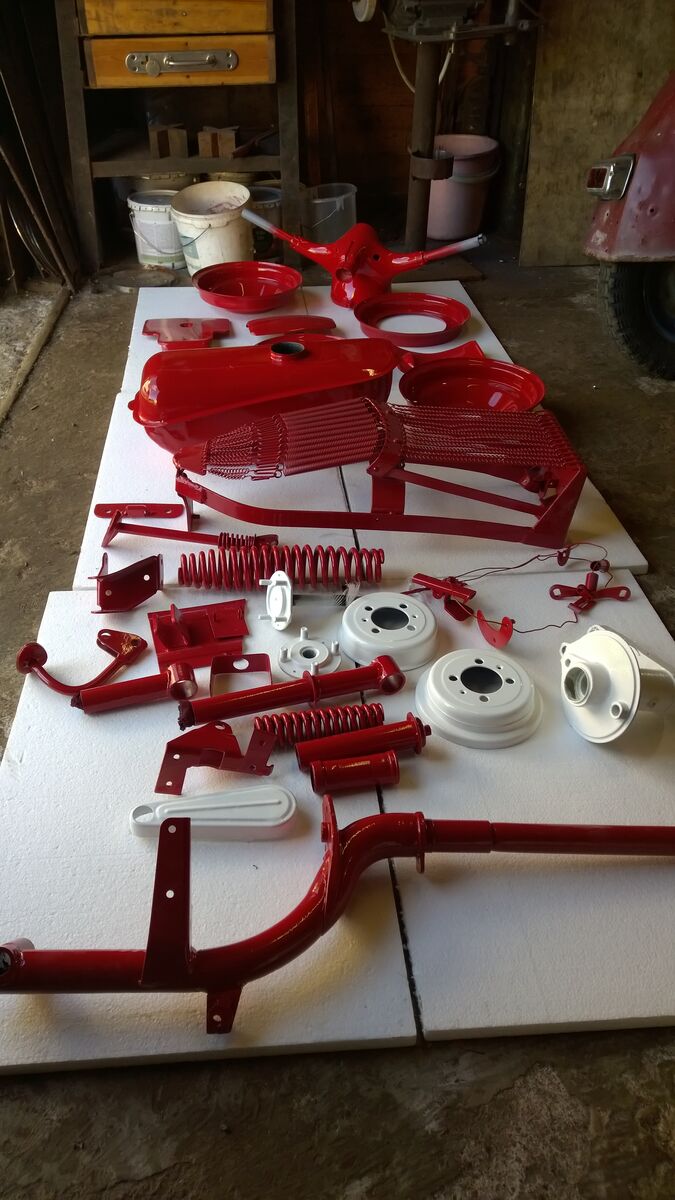

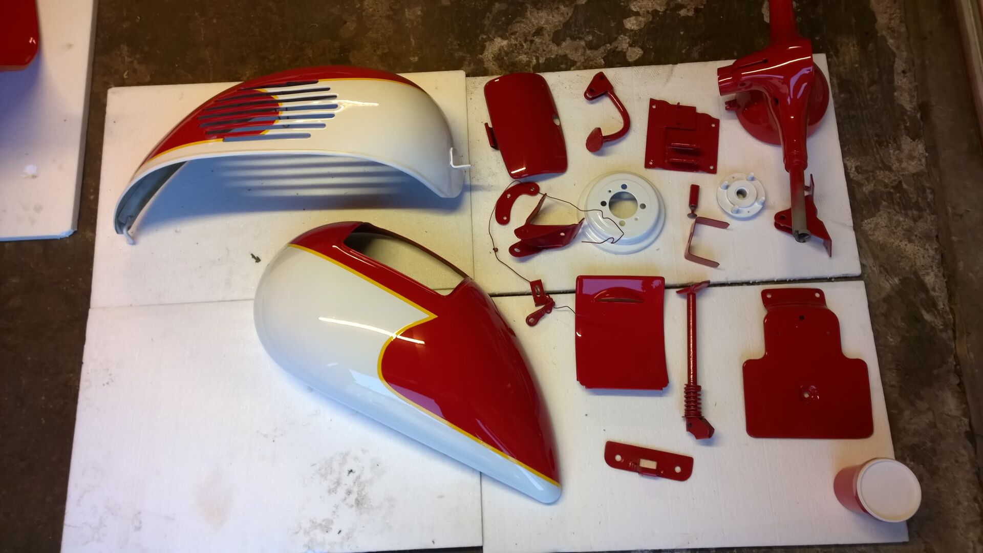

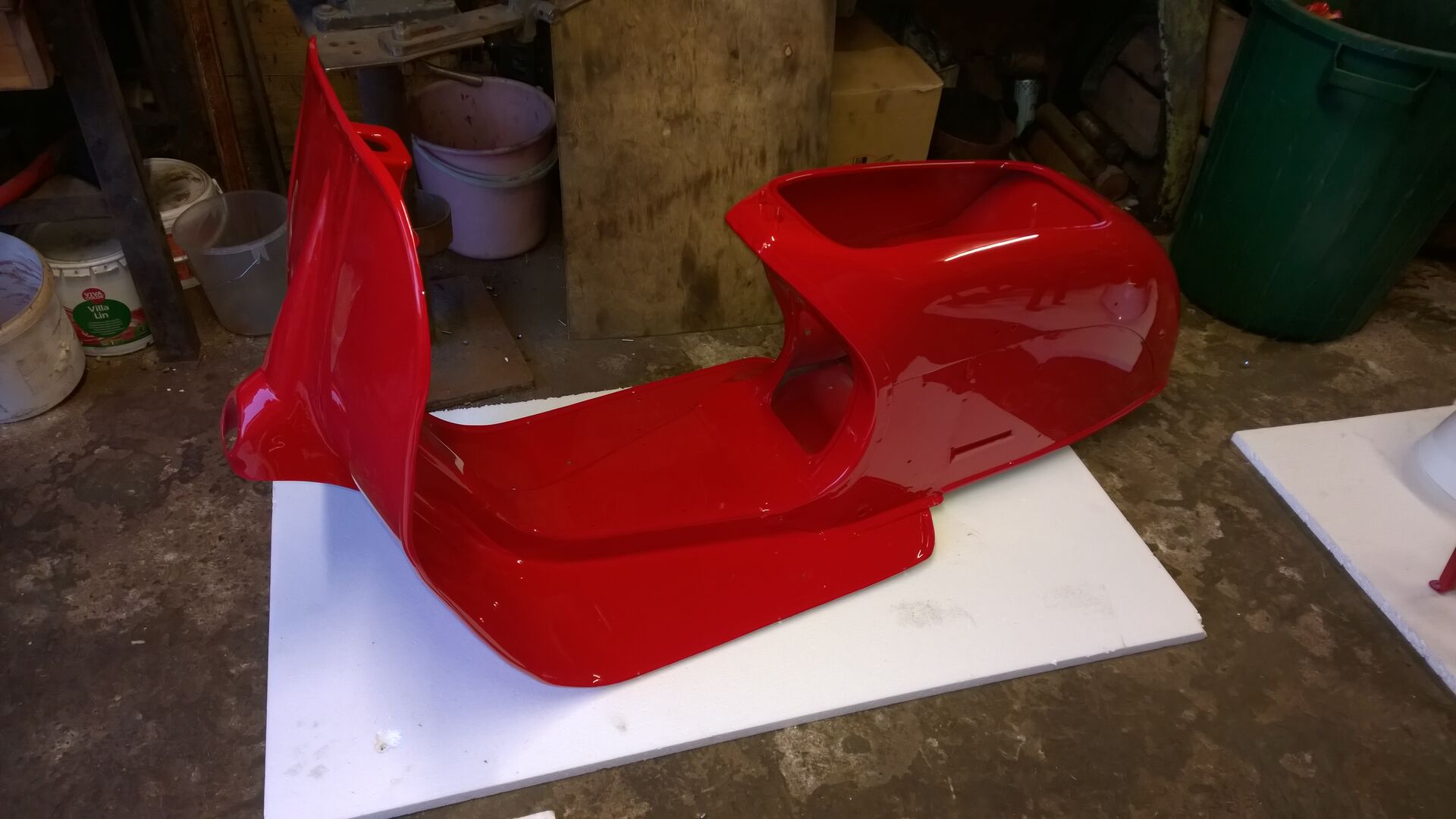

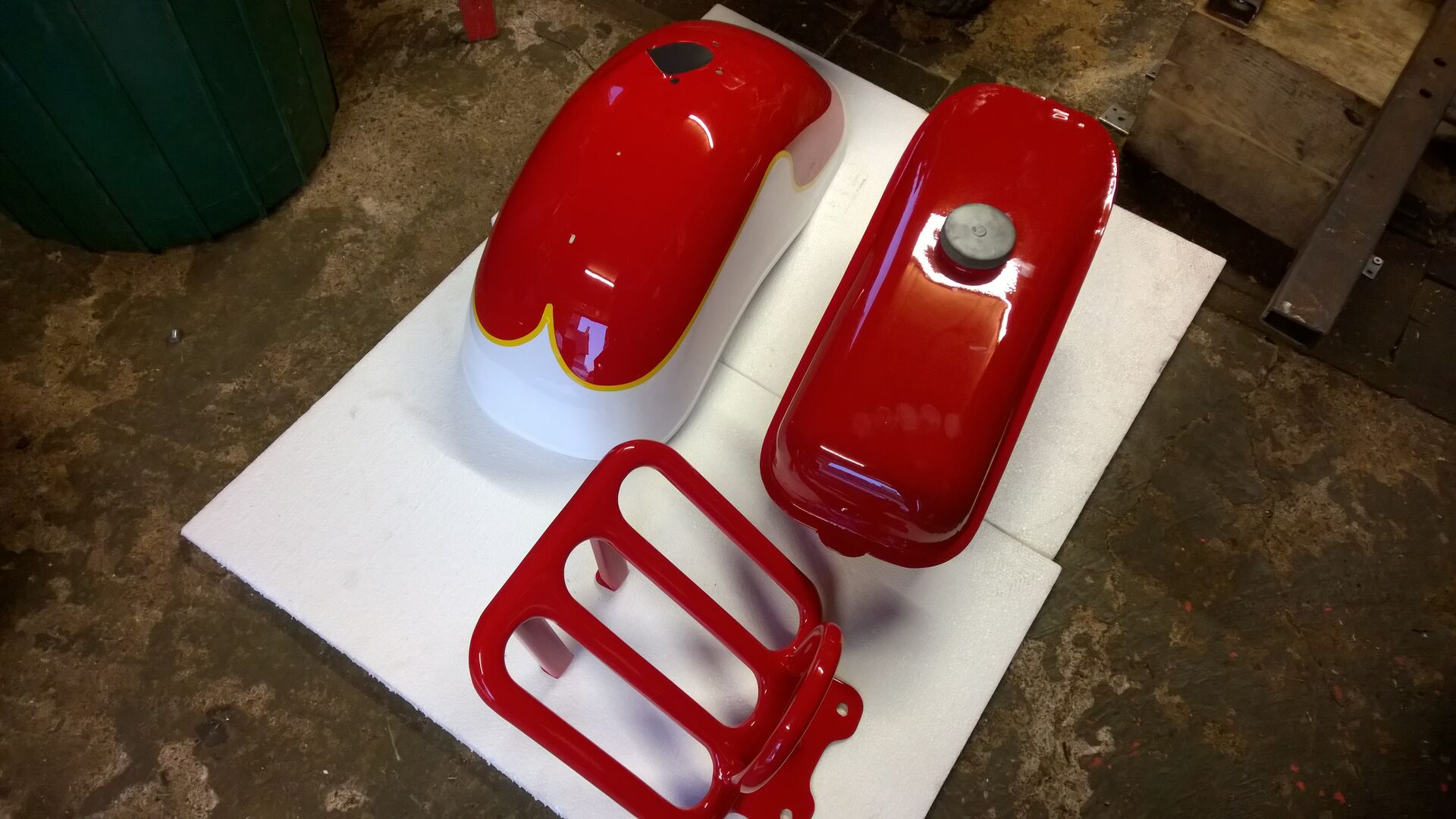

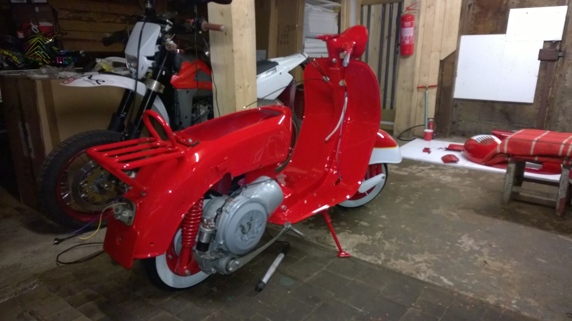

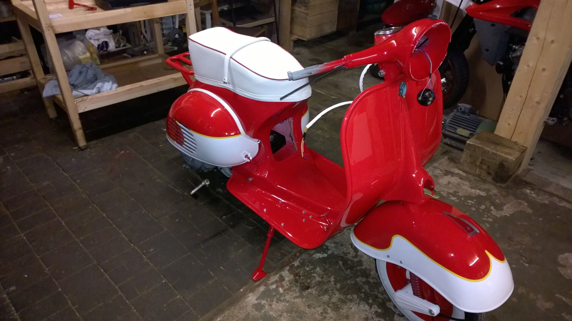

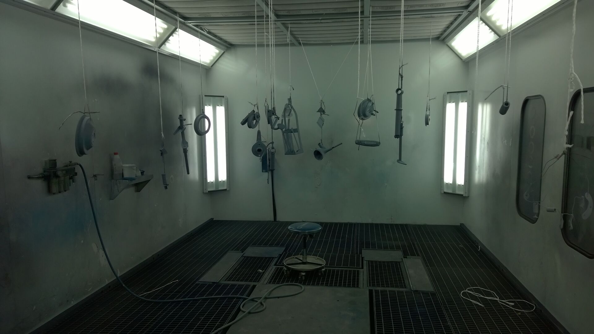

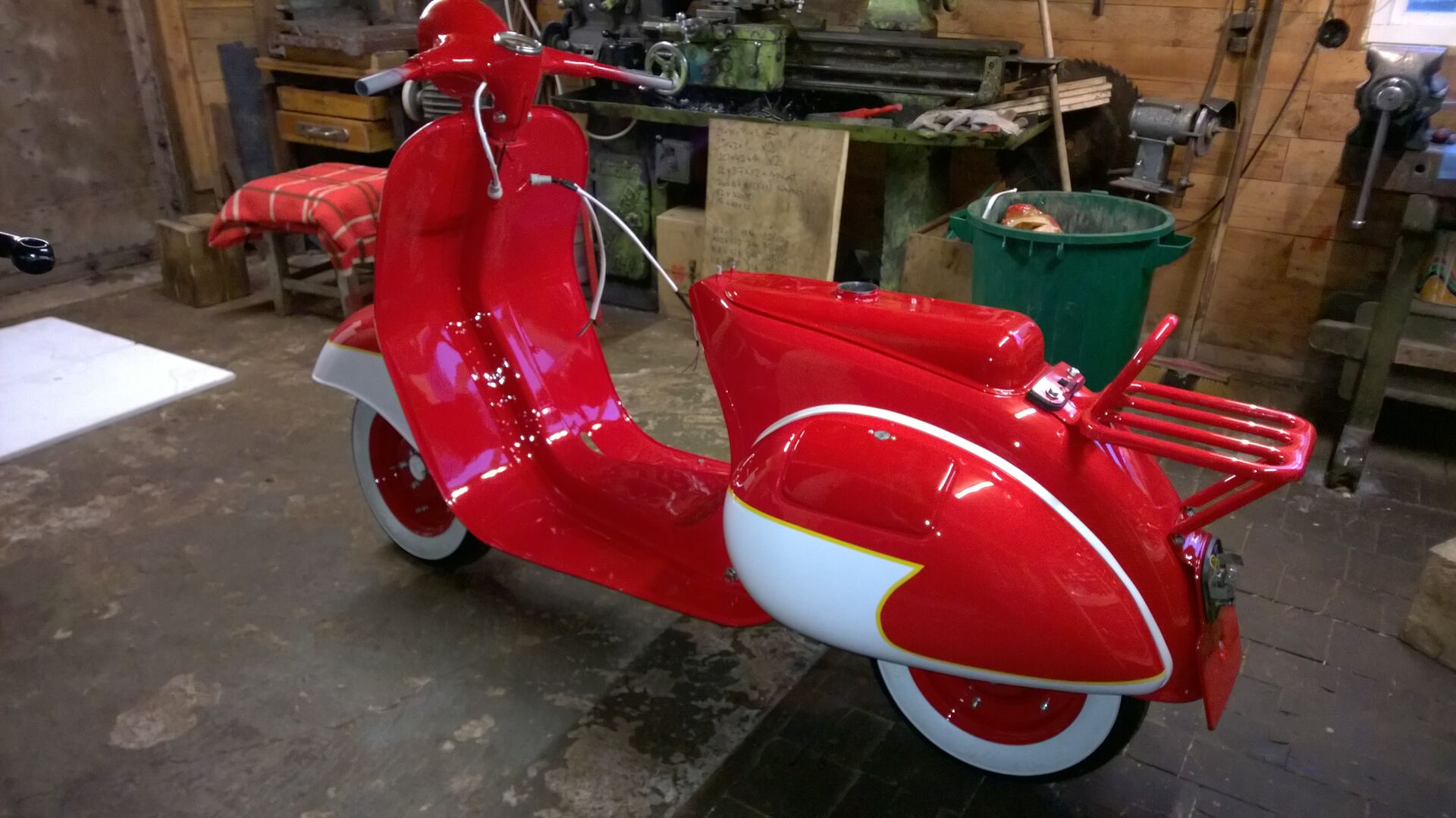

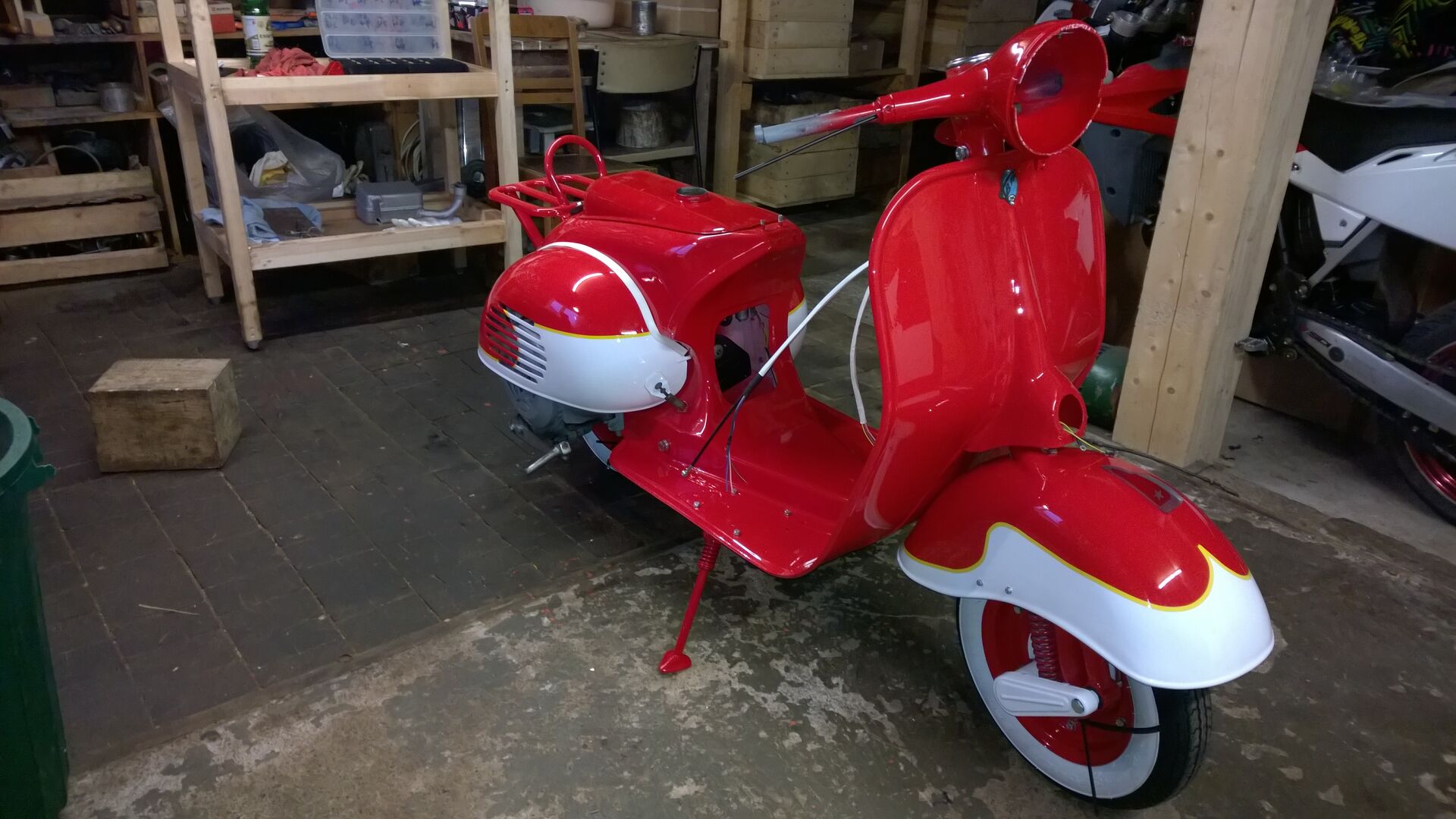

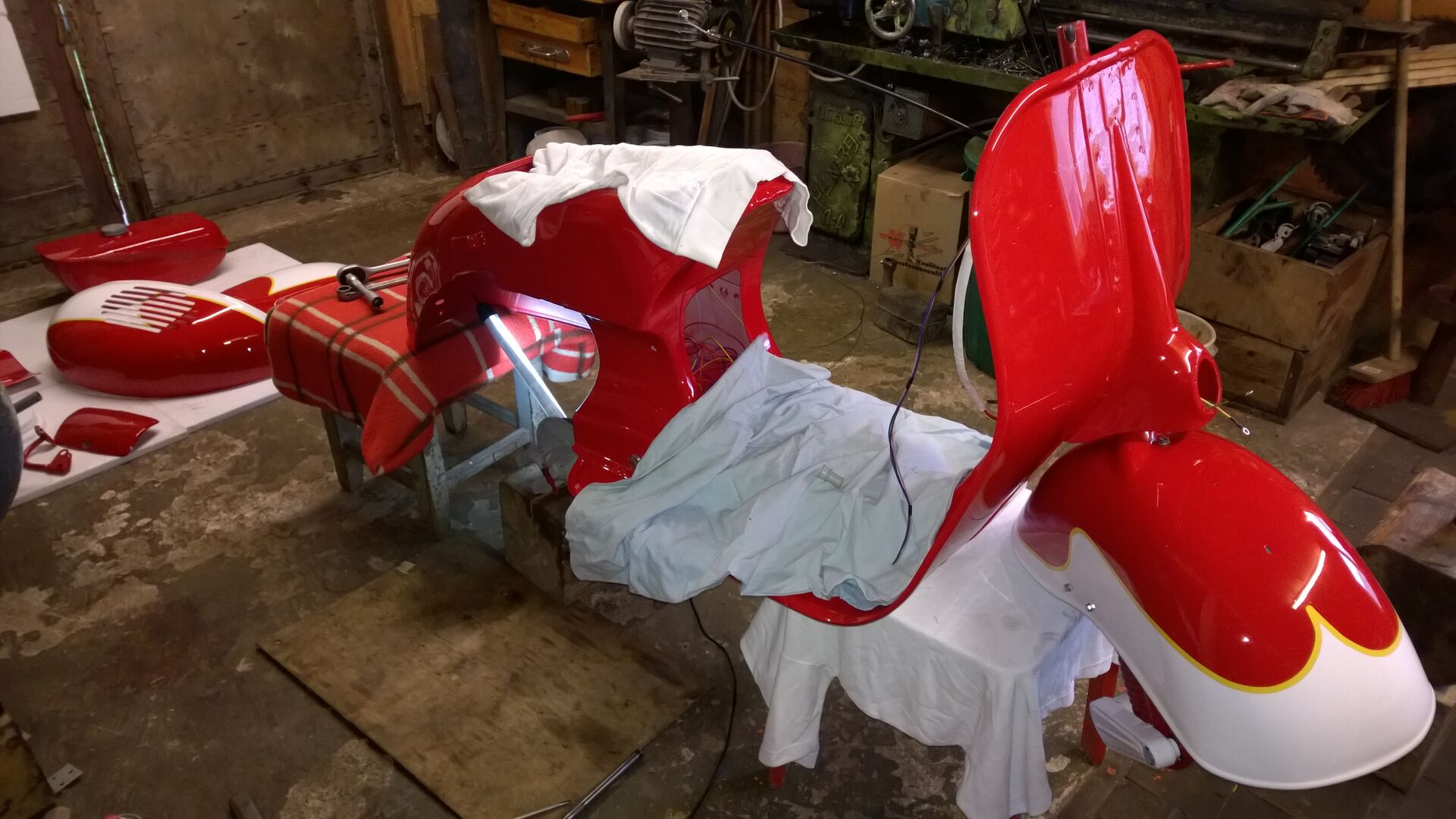

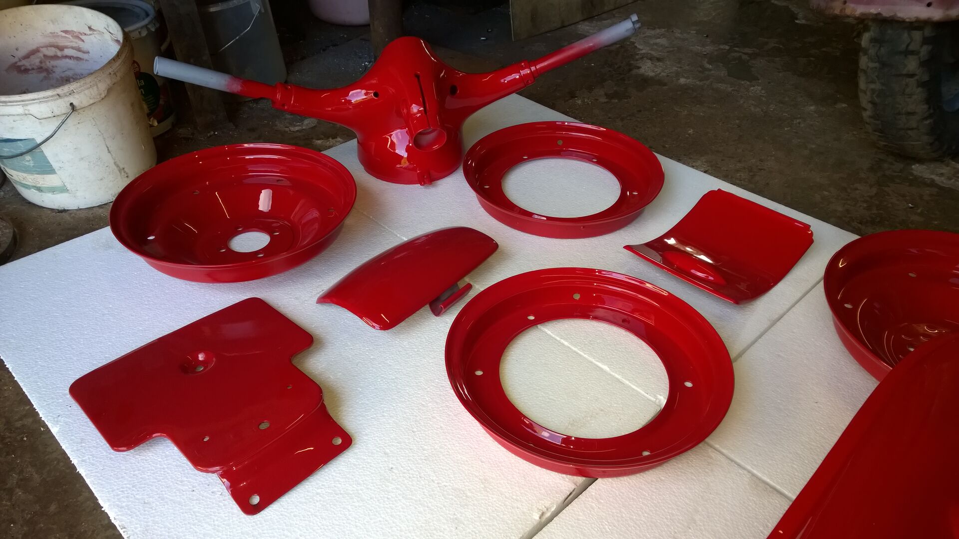

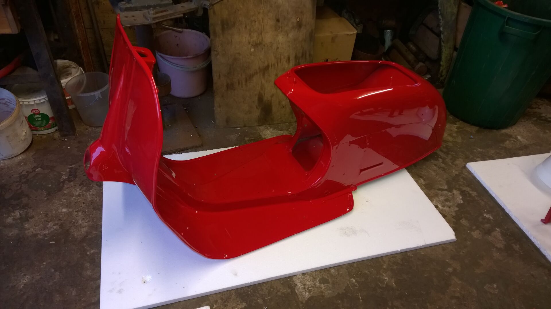

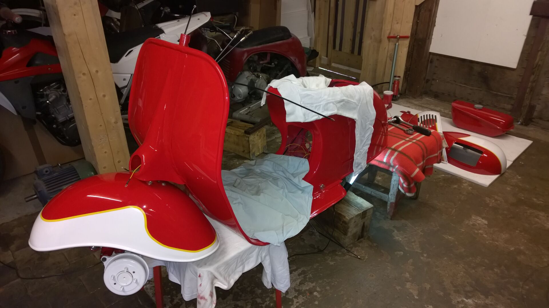

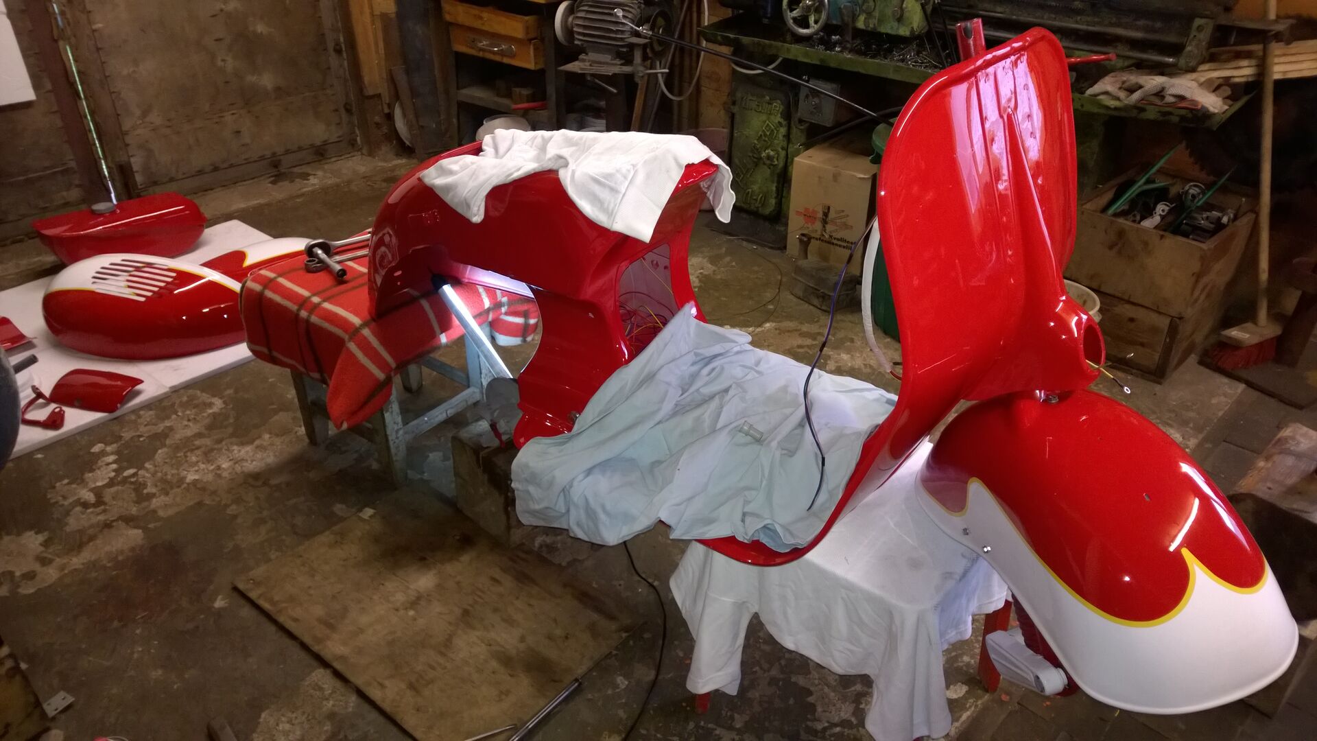

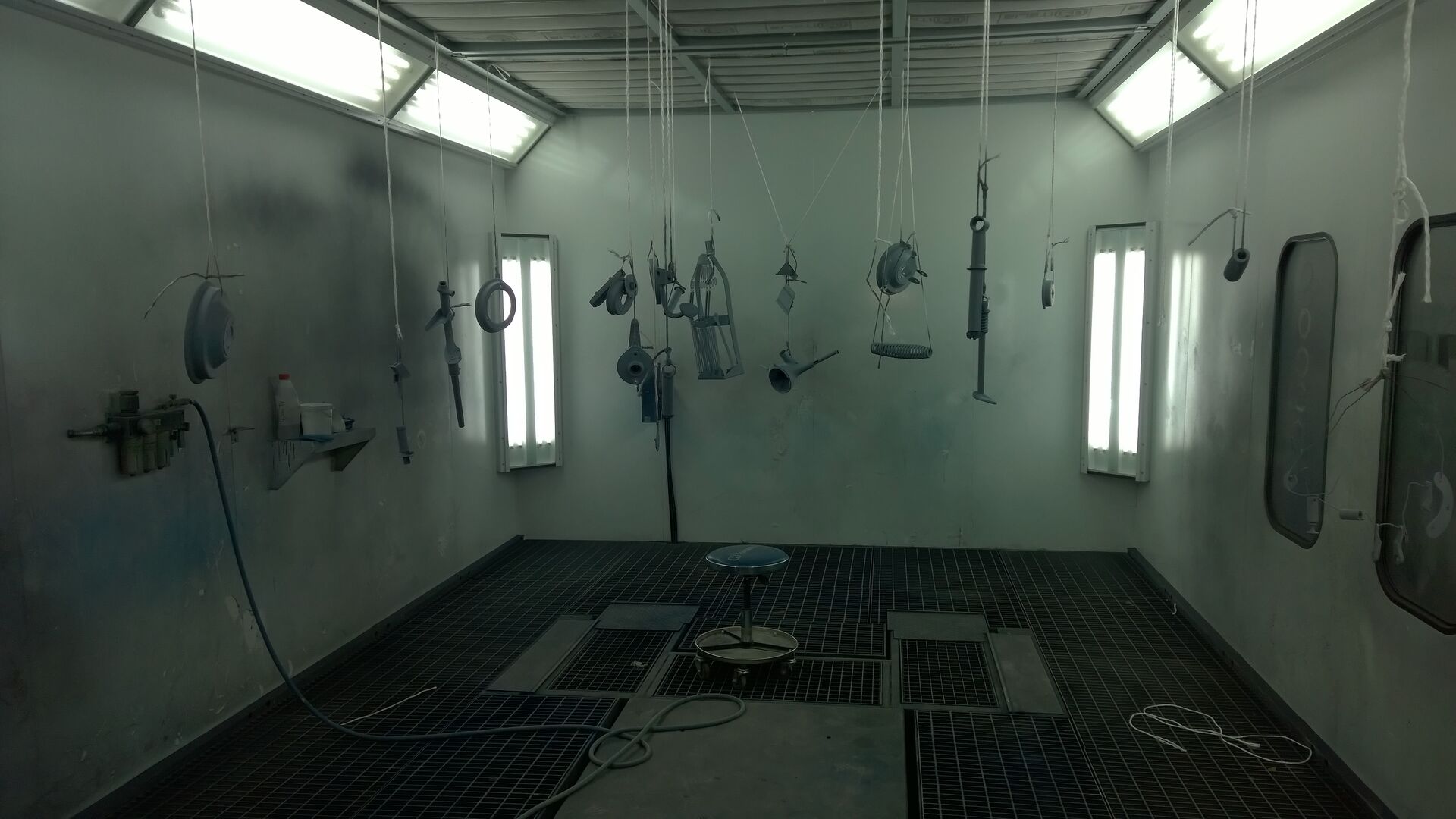

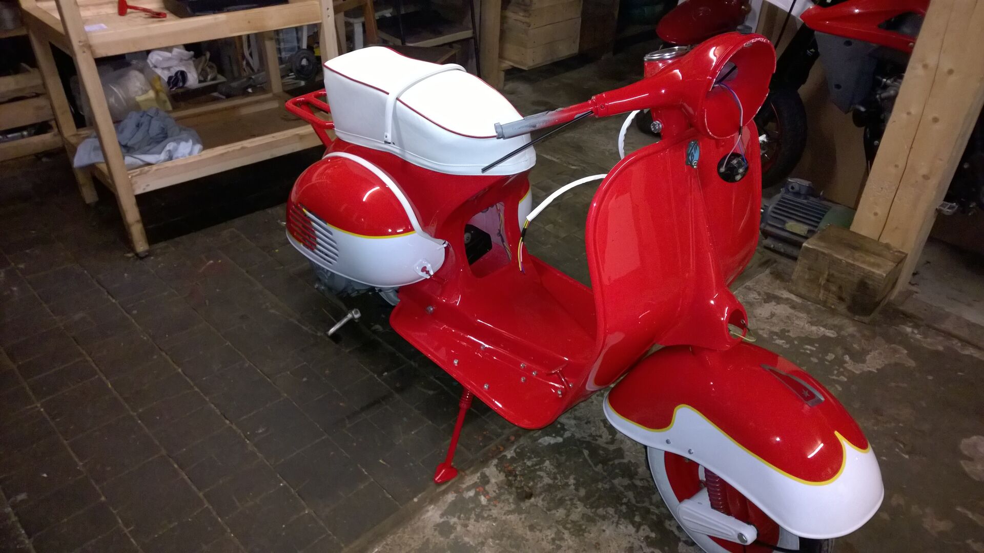

    Paint job is done. 8)

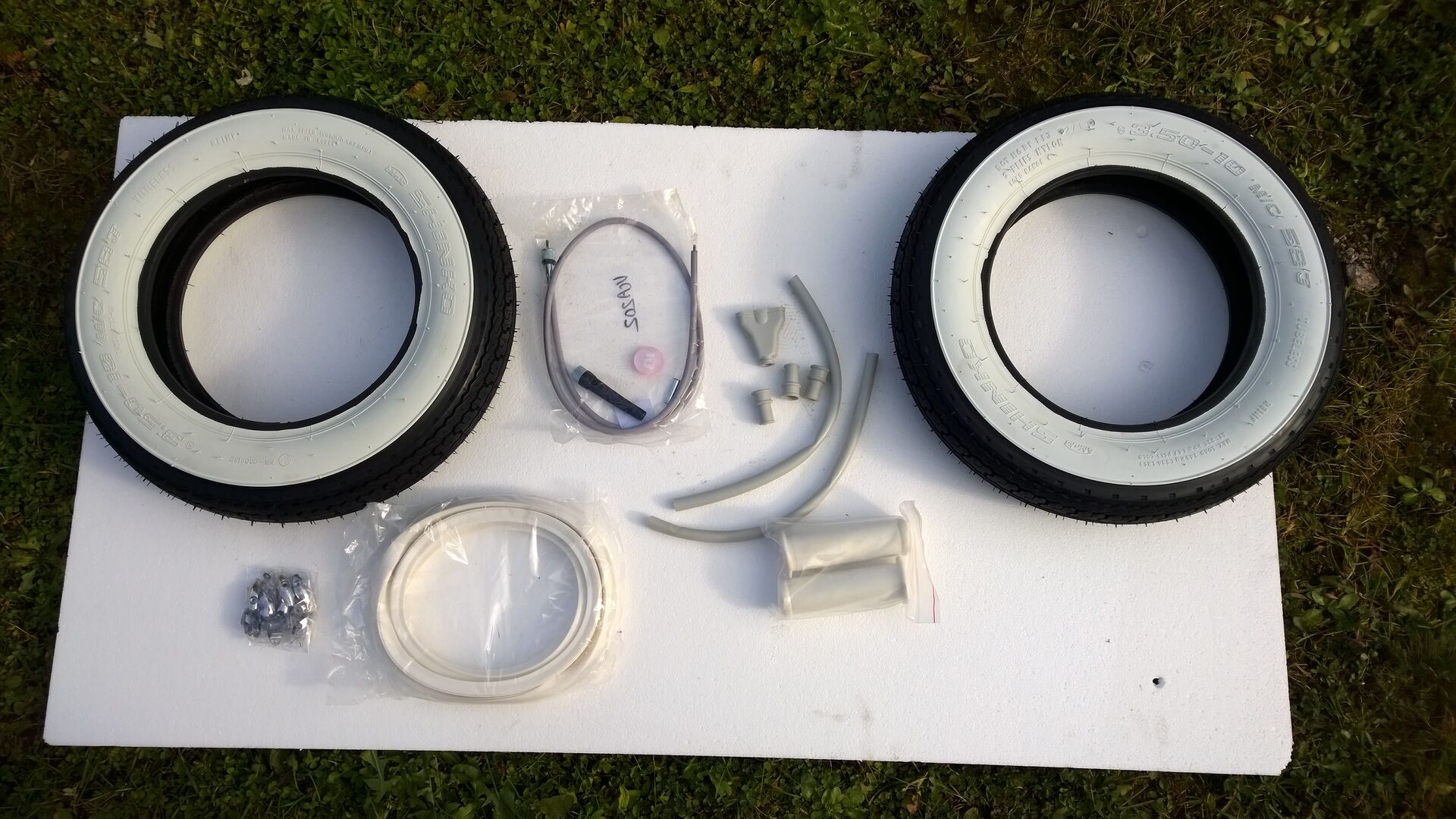

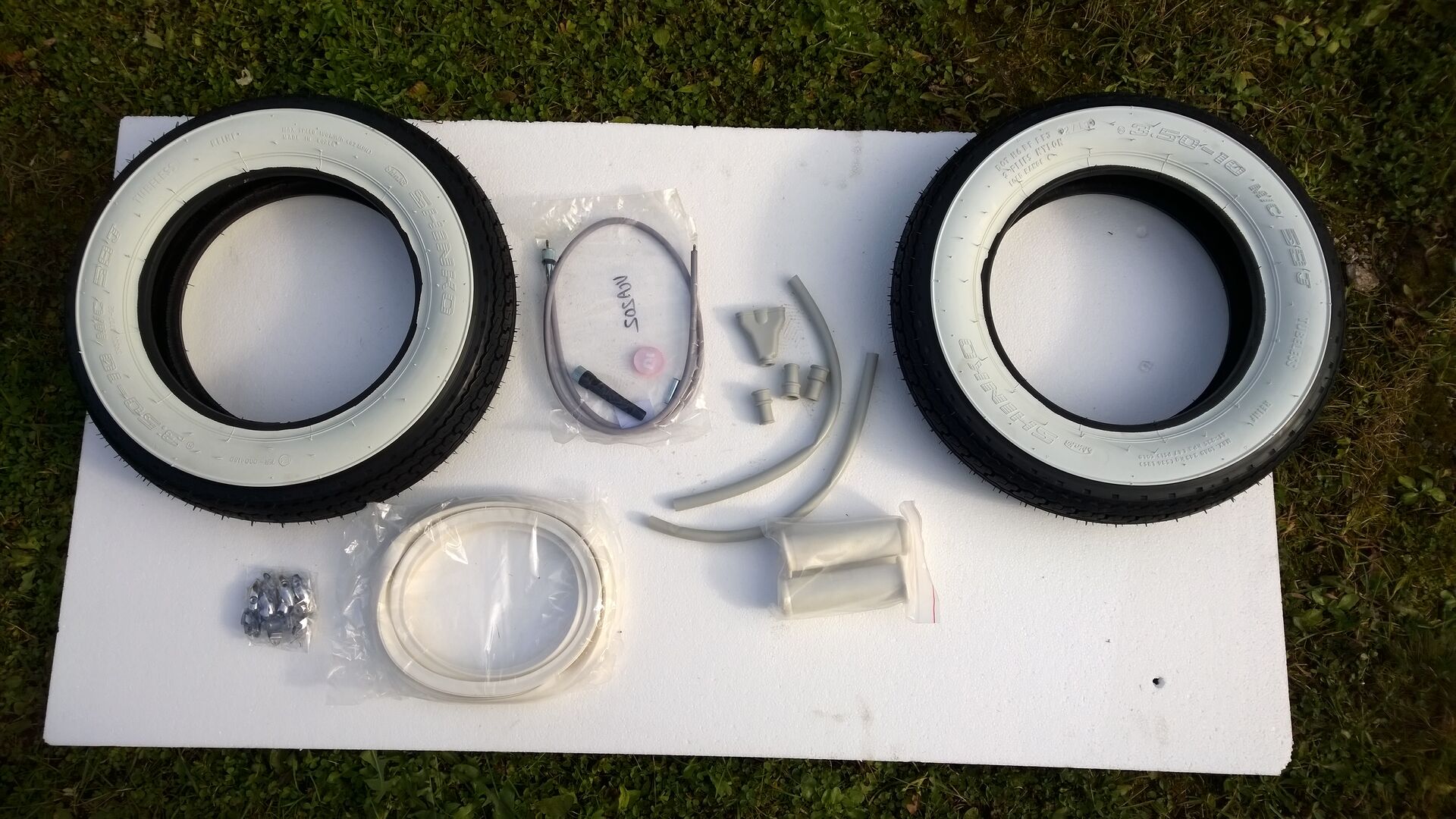

    All new rubber details are from England. These belongs to Vespa, but also fits for Vjatka too.

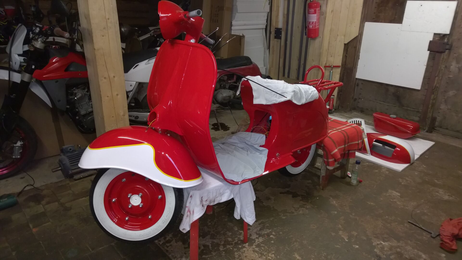

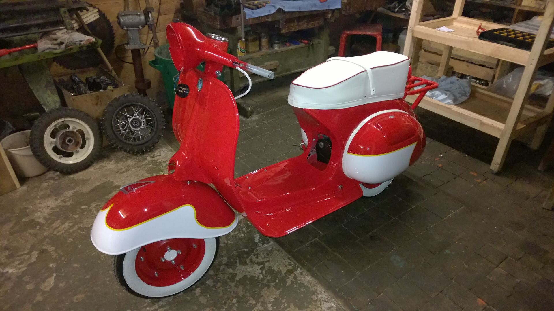

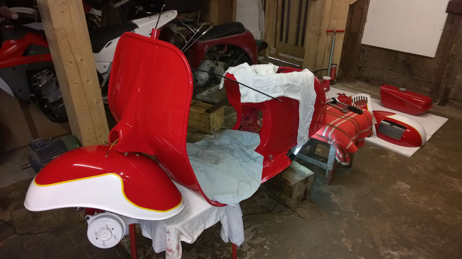

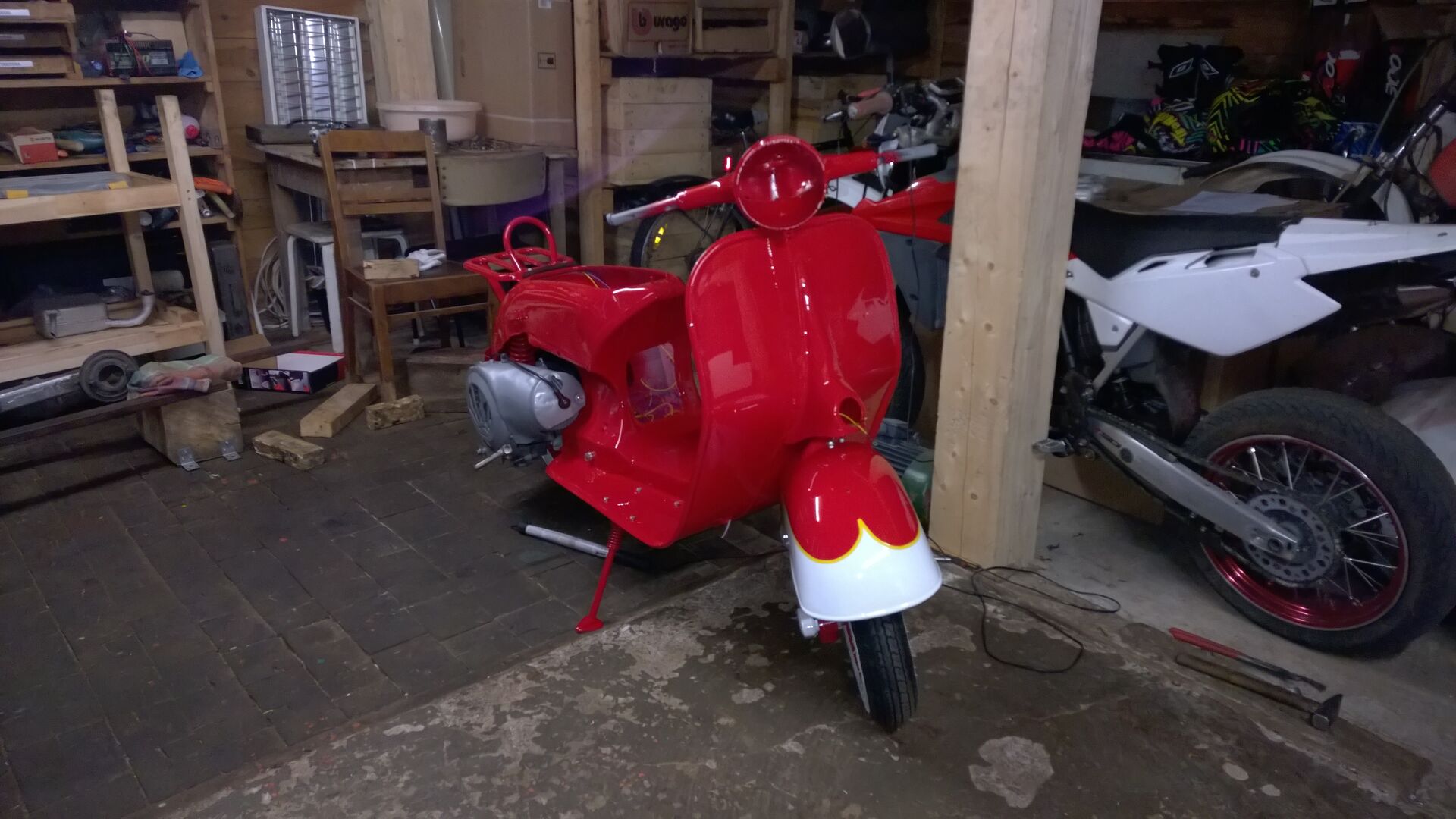

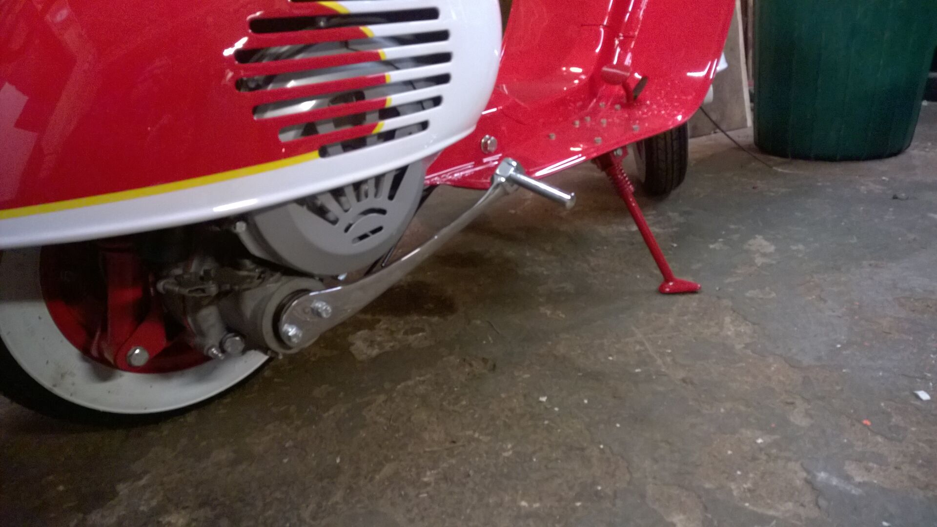

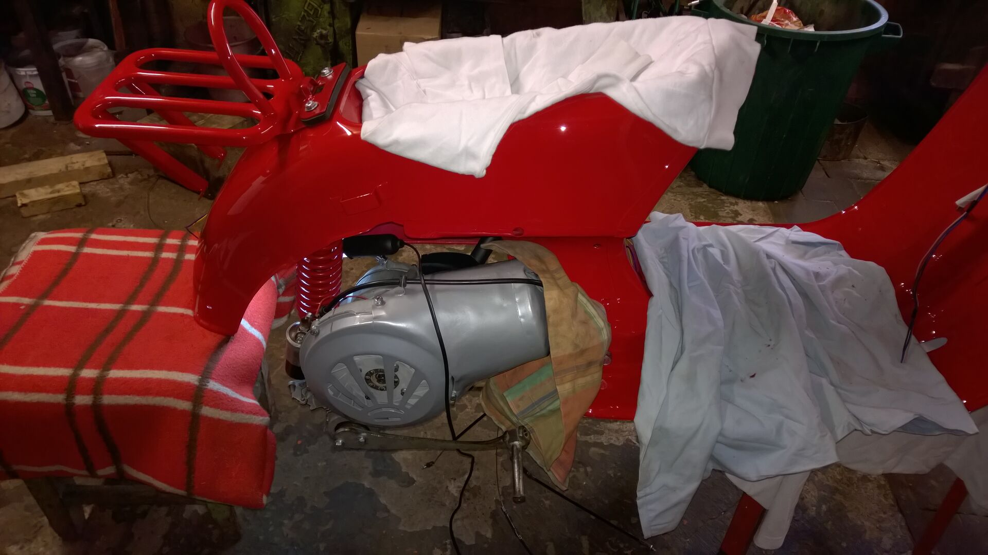

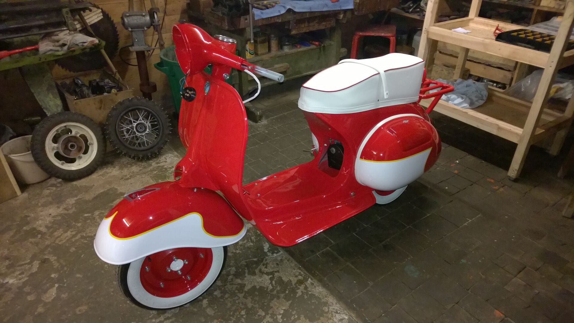

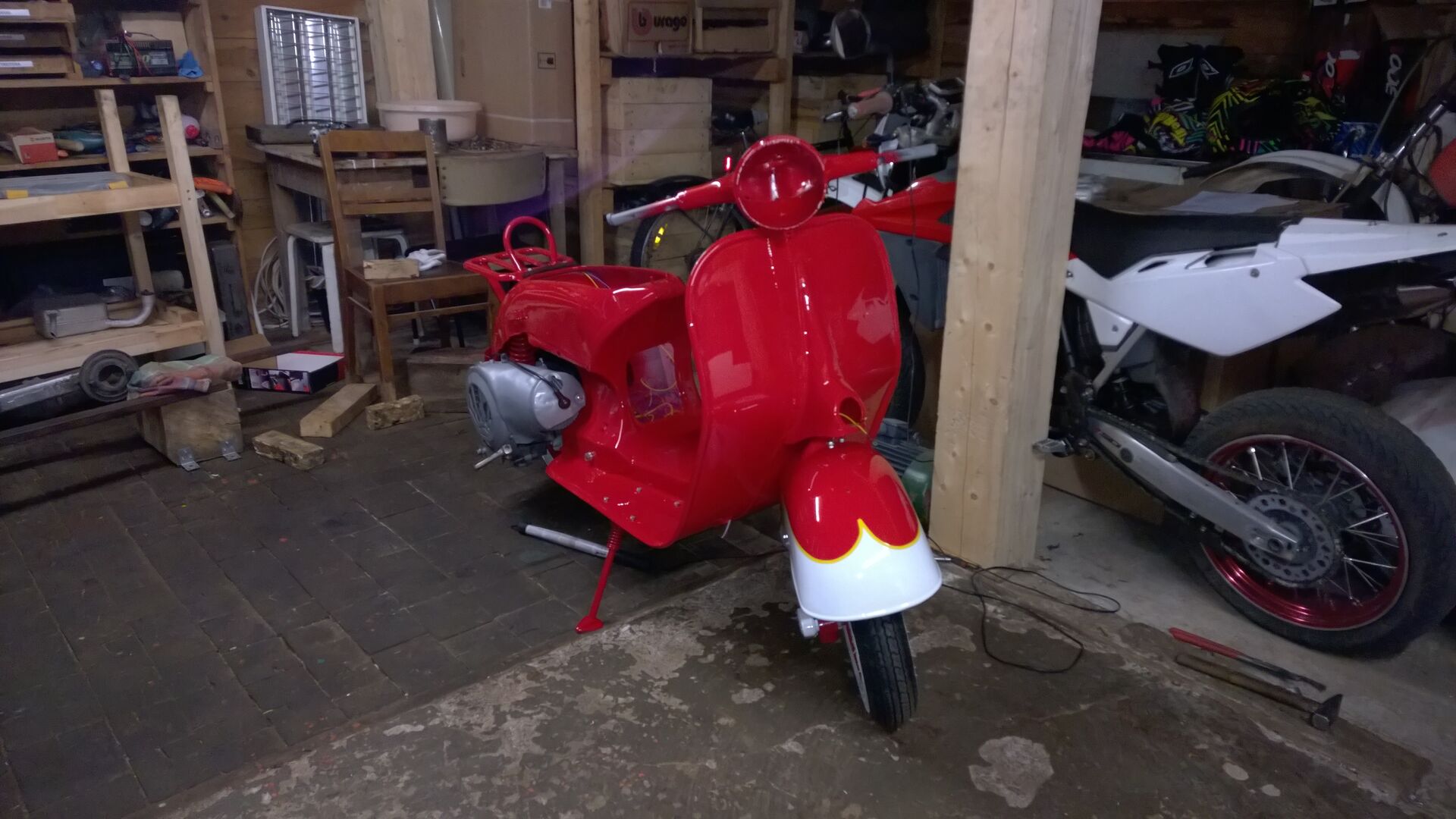

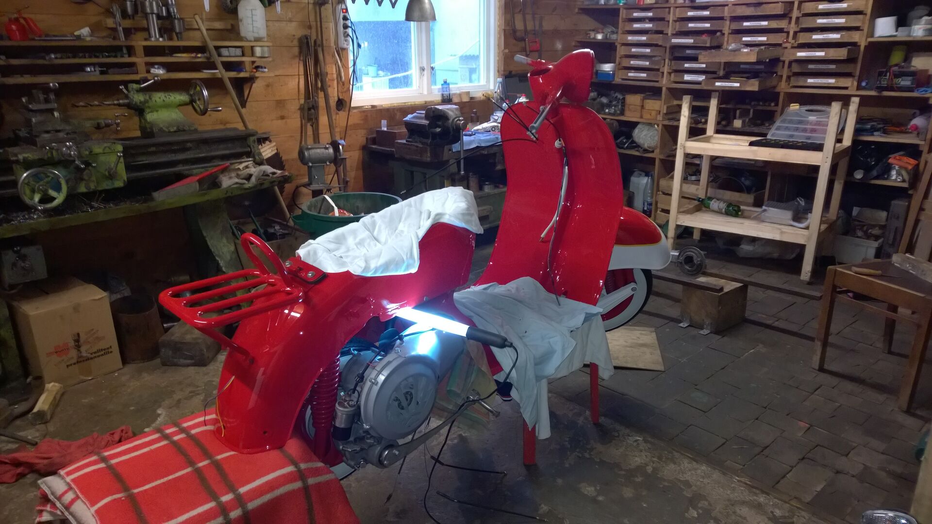

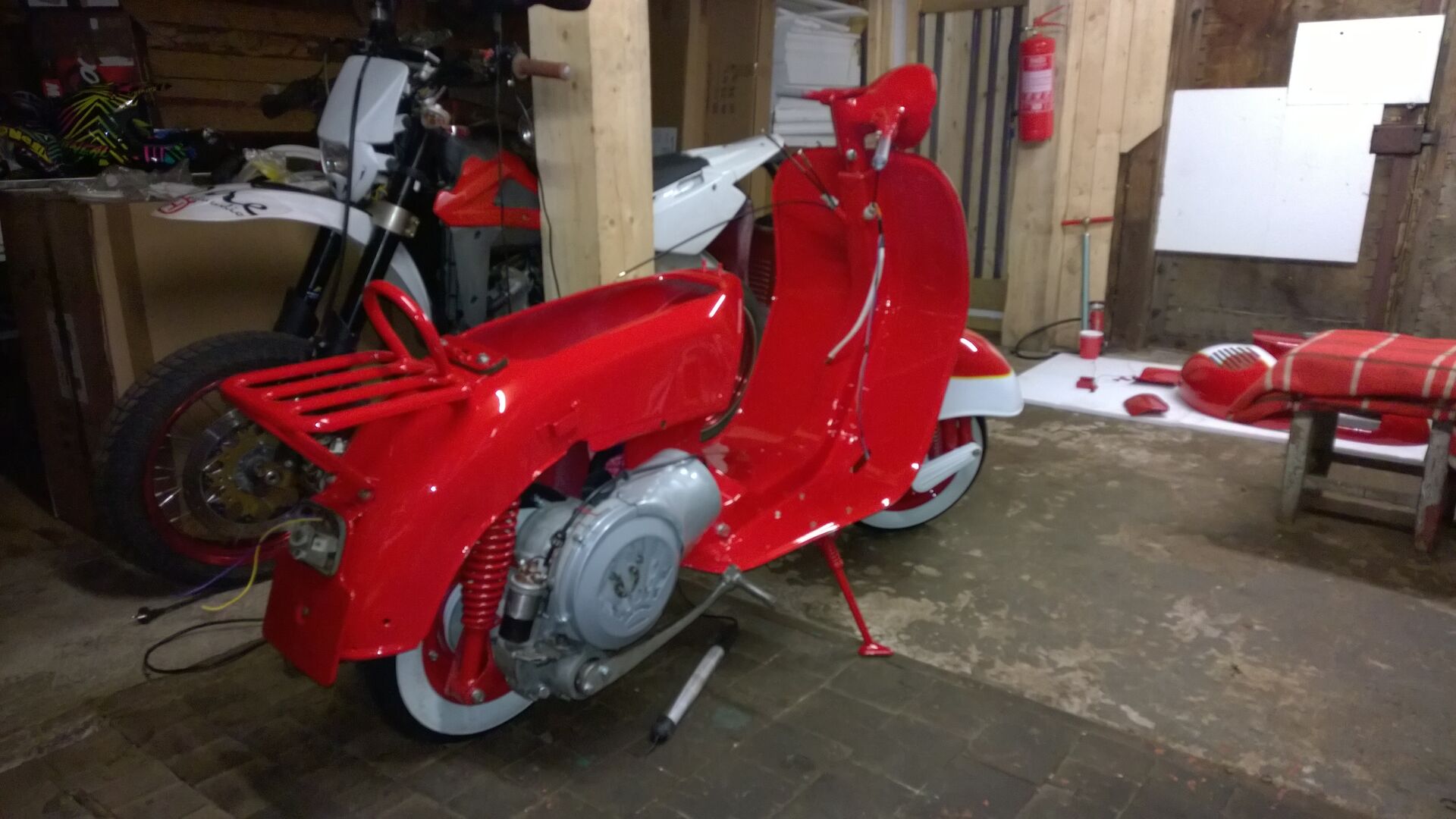

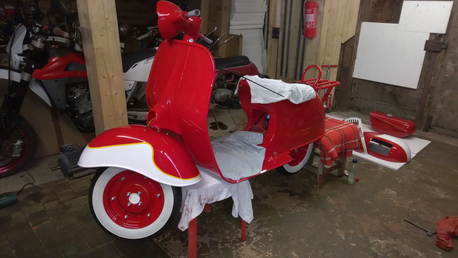

    Began assembling.

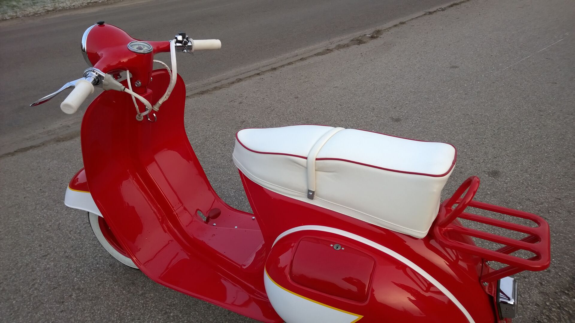

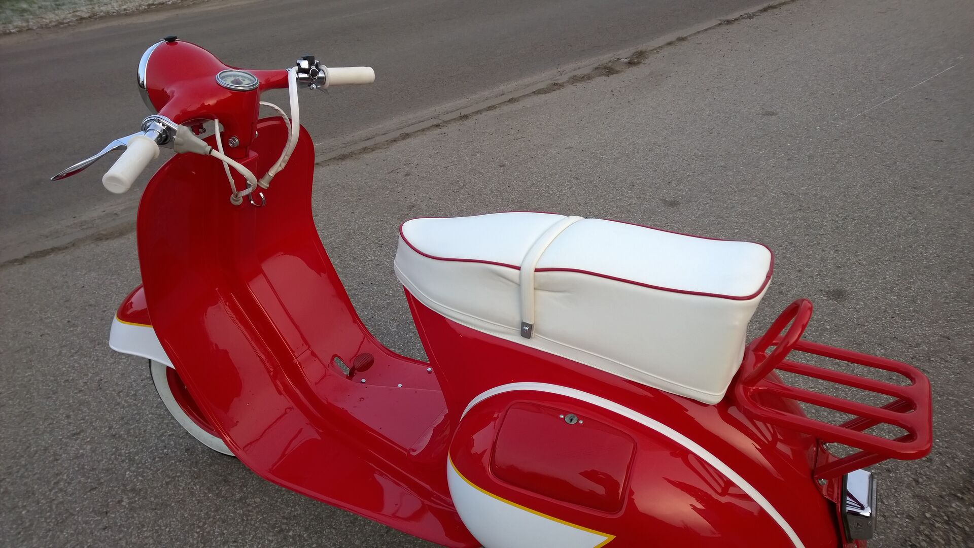

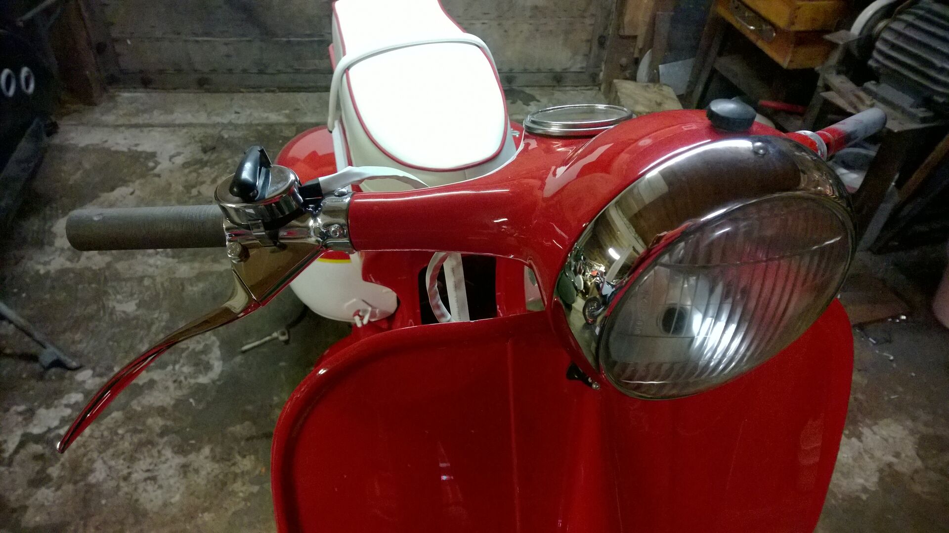

    Brand new saddle.

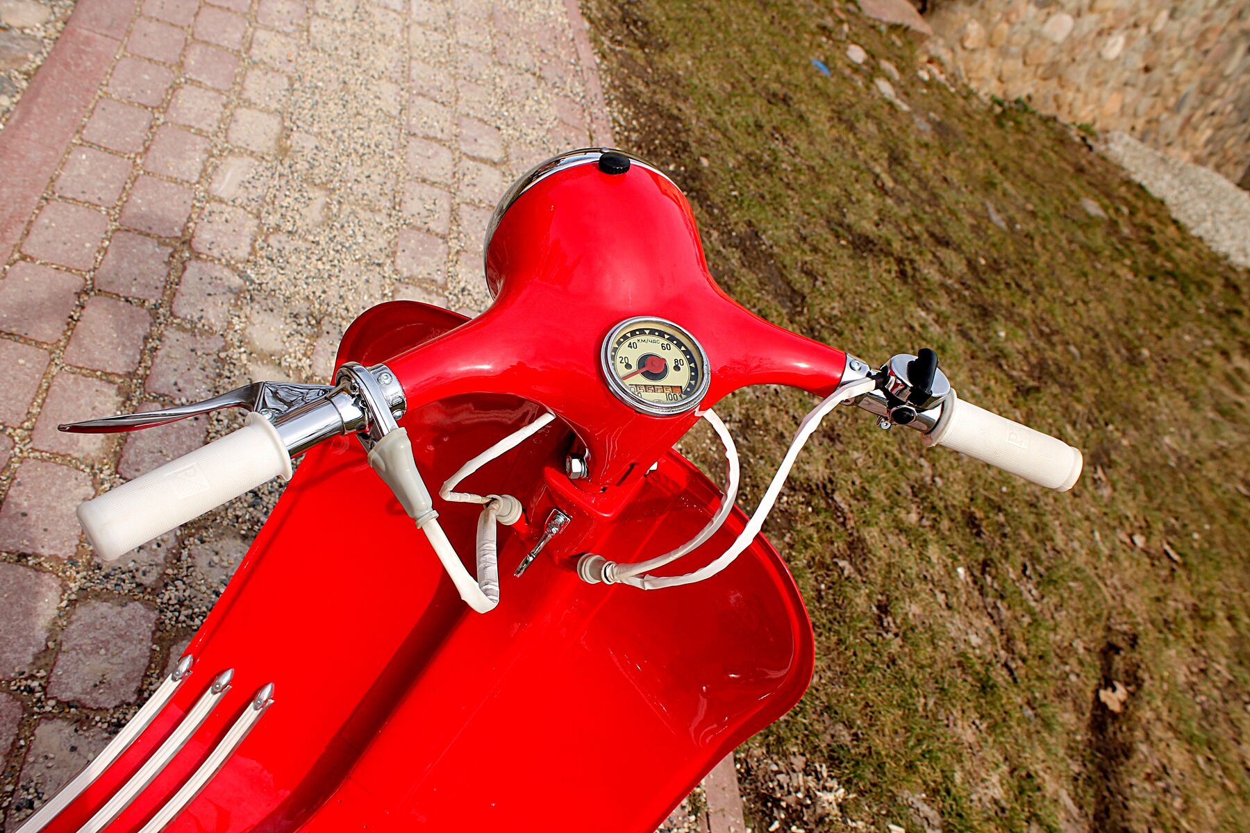

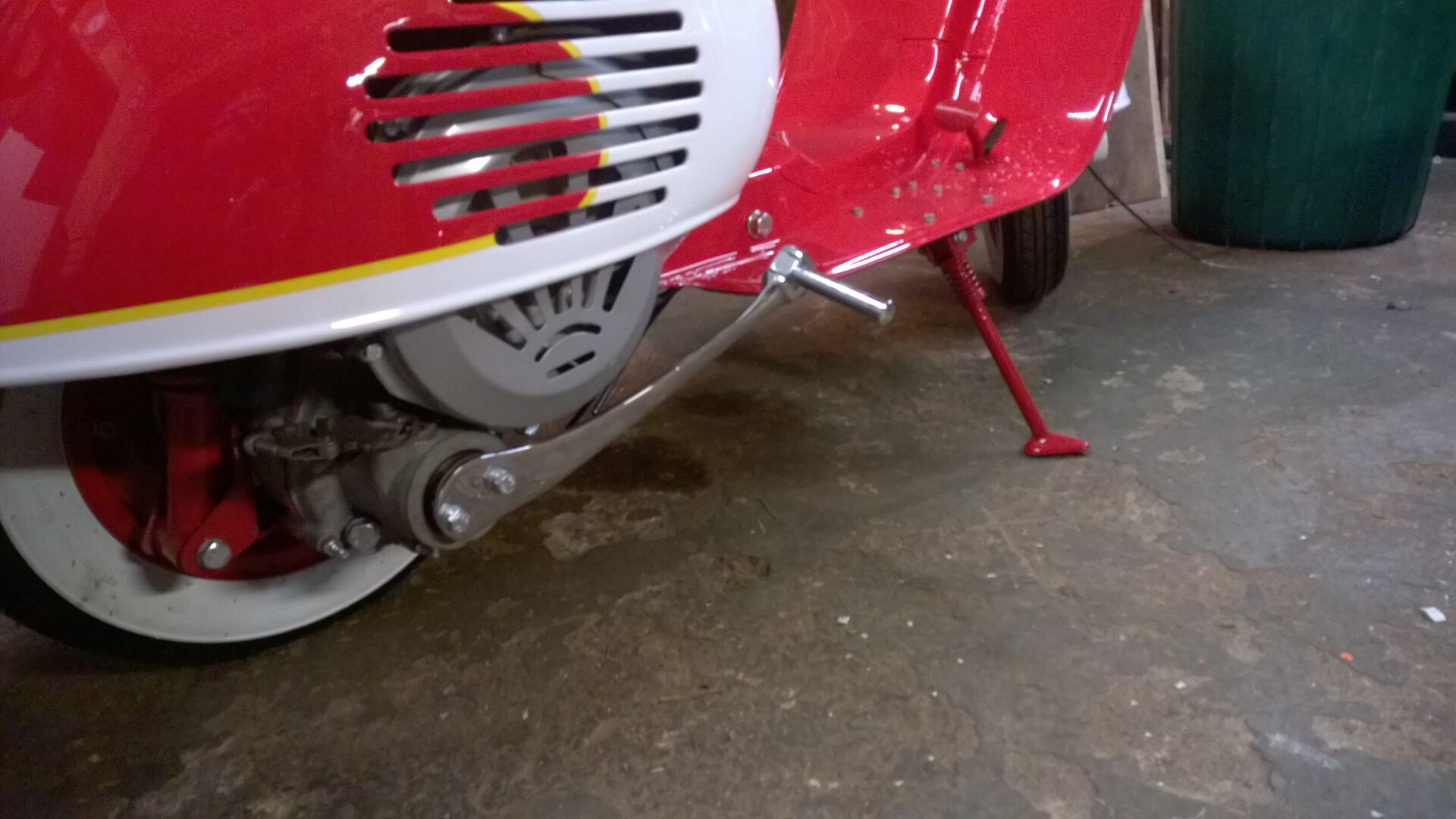

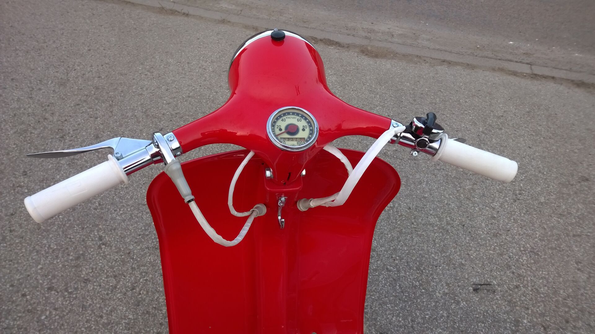

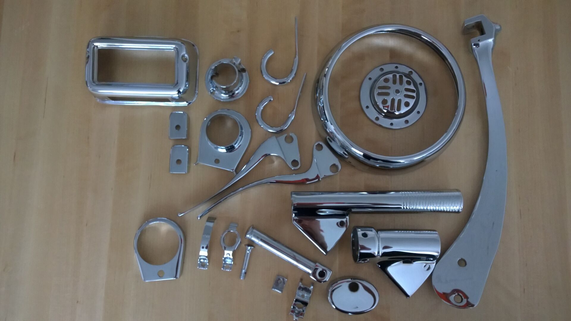

    Rechromed details. Very smood and beautiful.

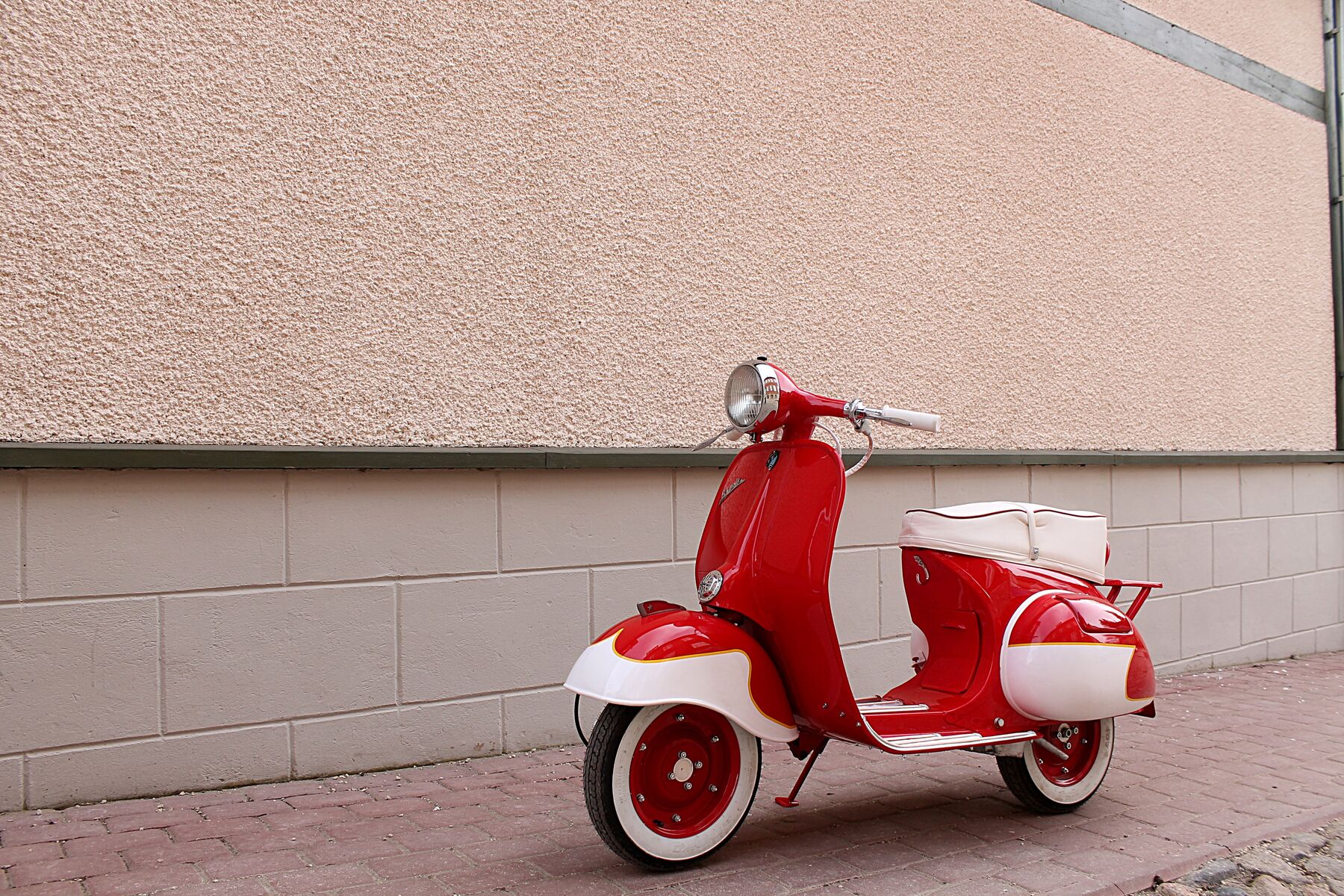

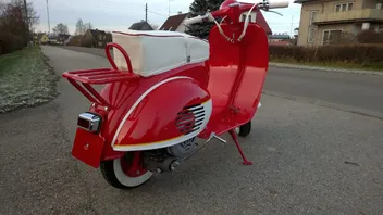

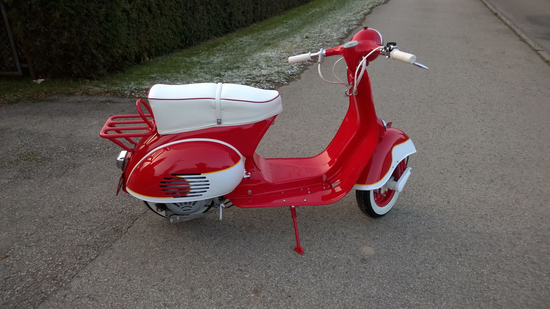

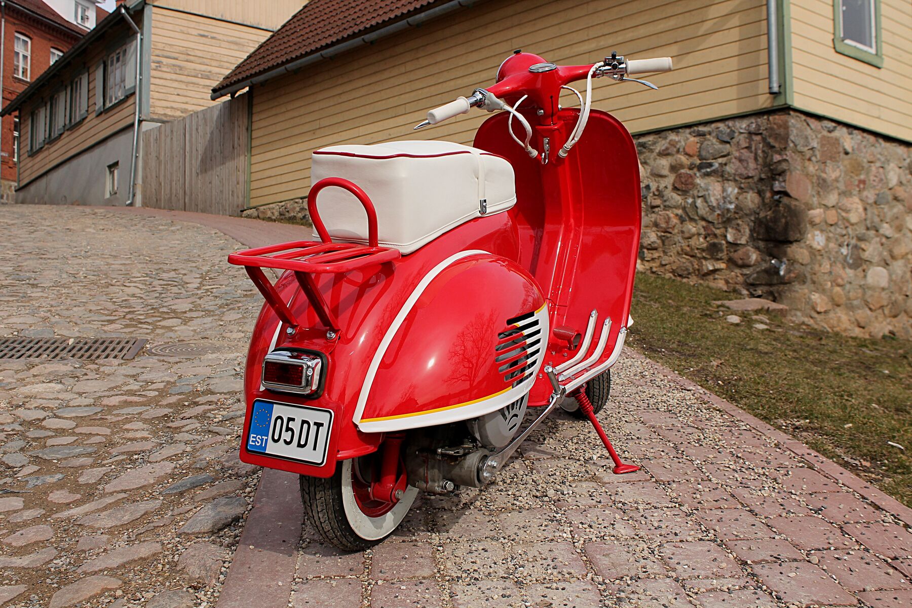

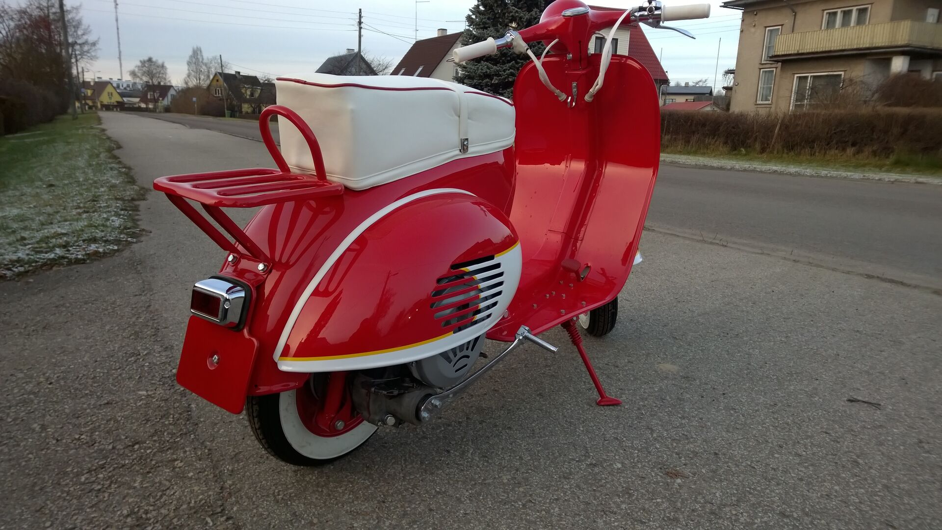

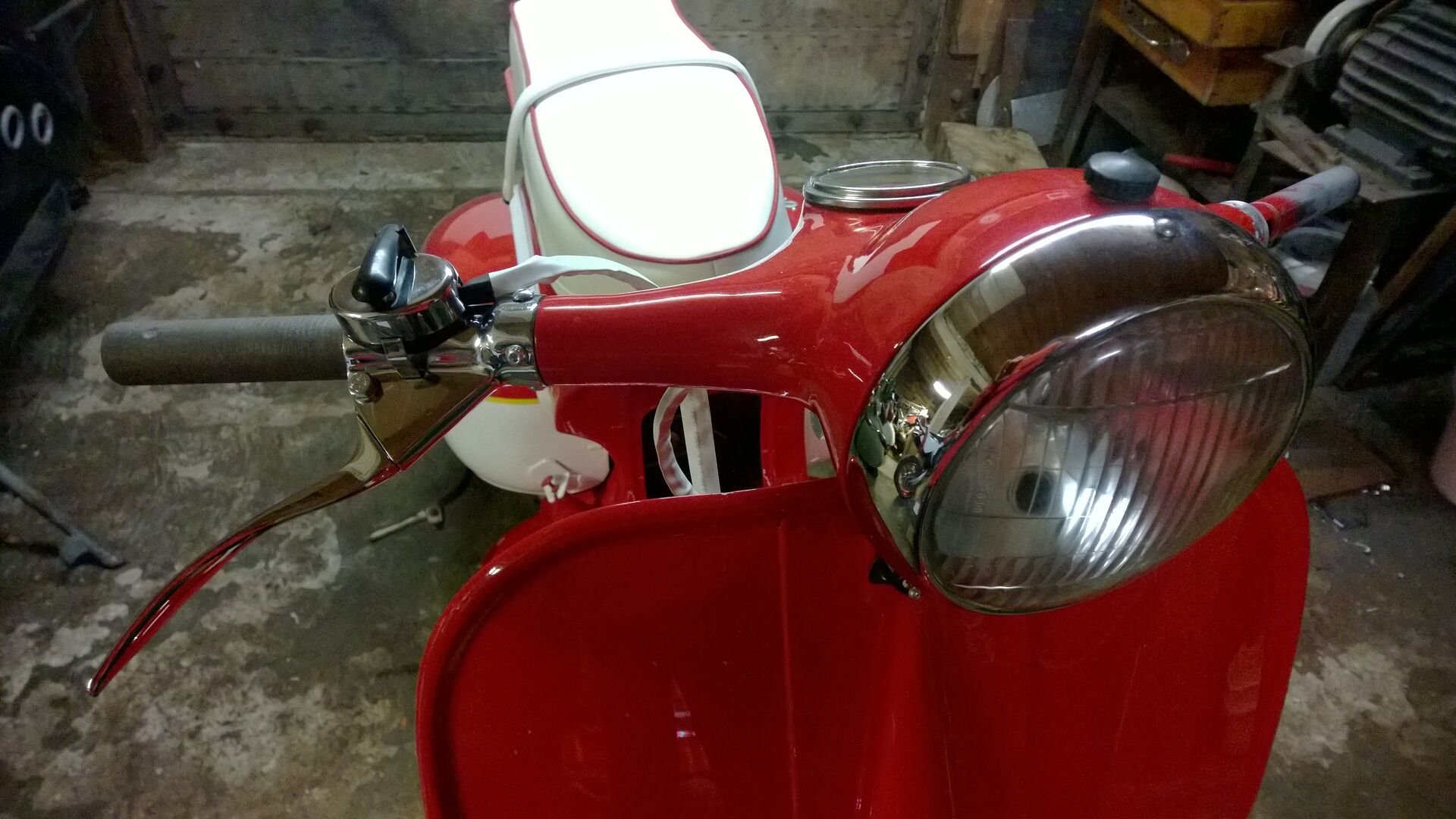

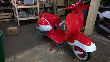

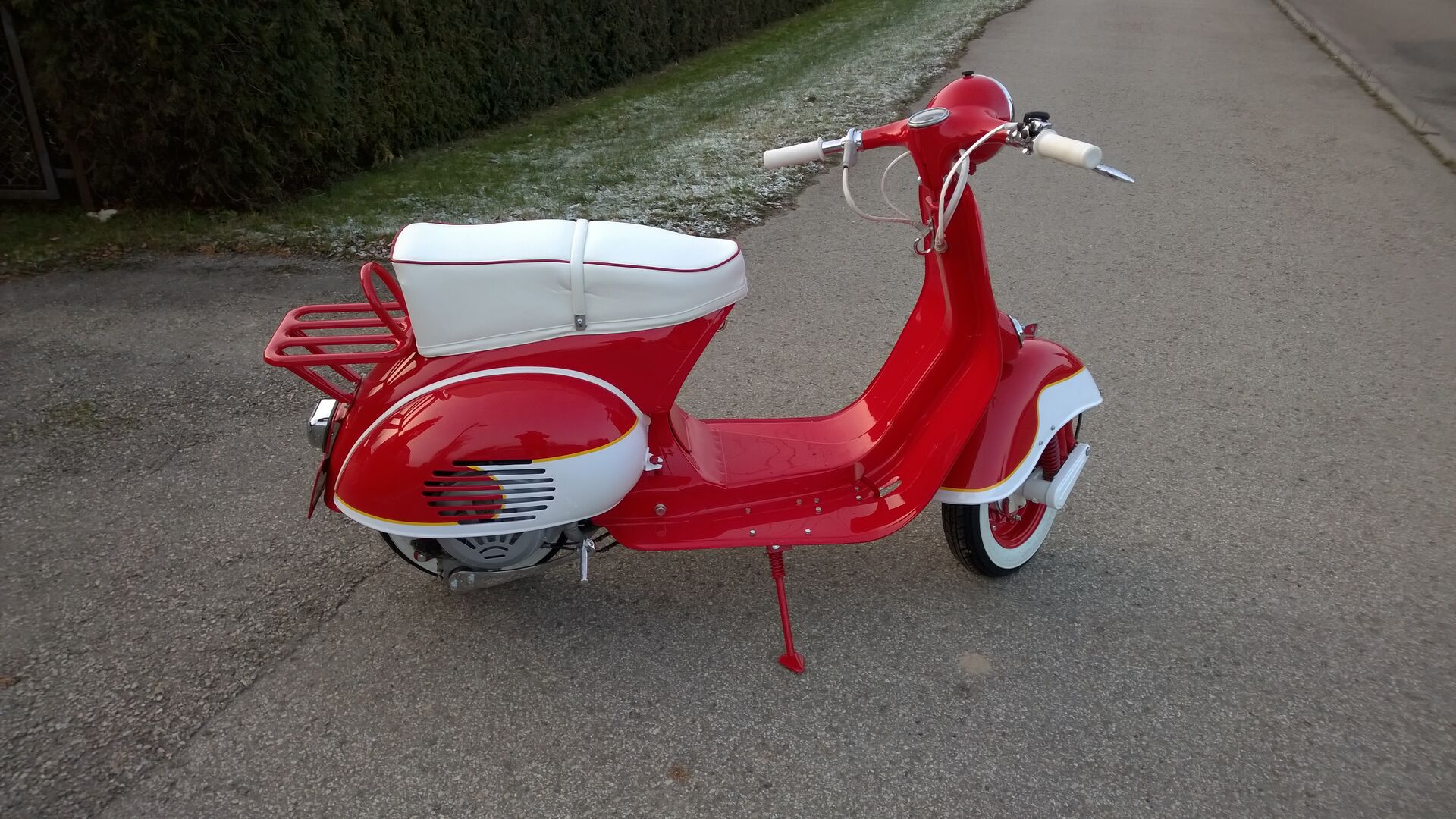

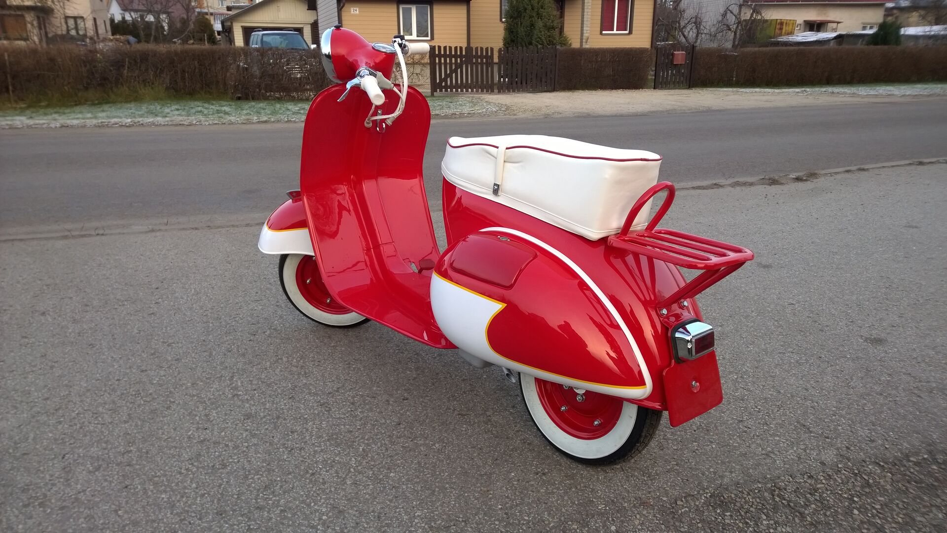

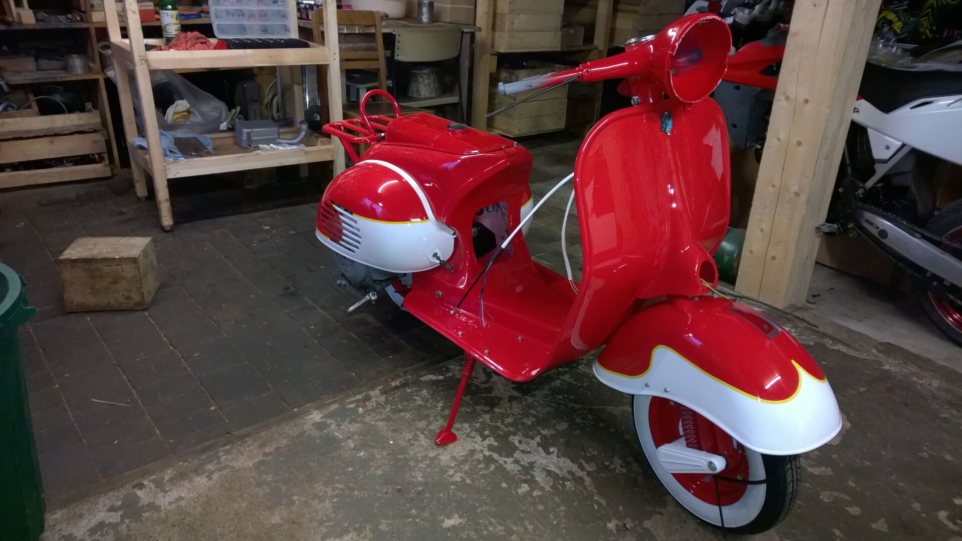

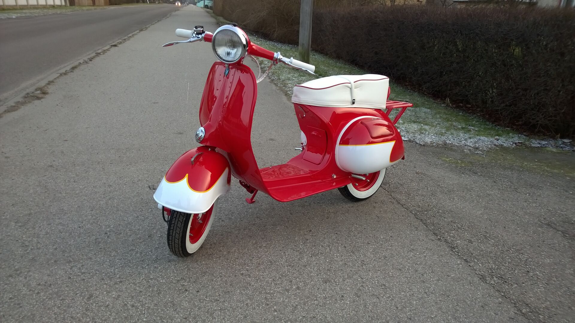

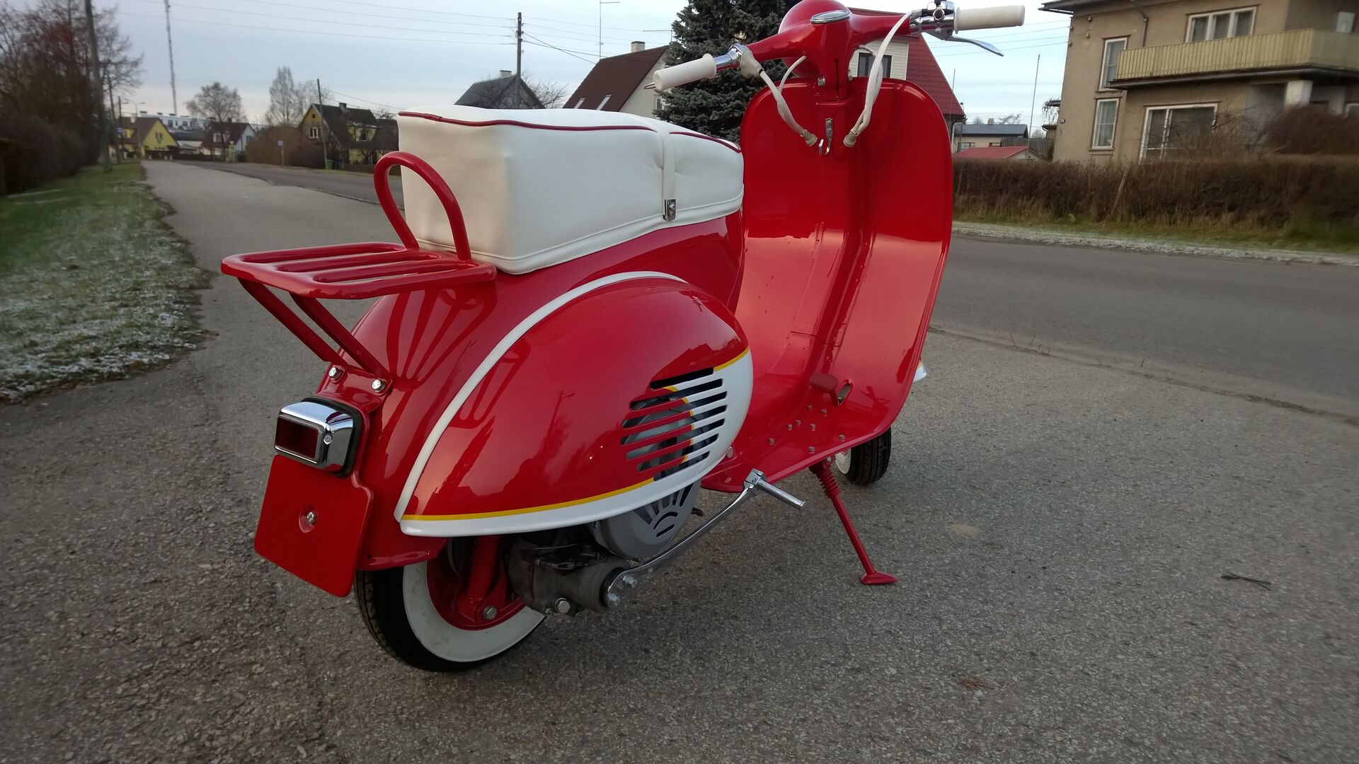

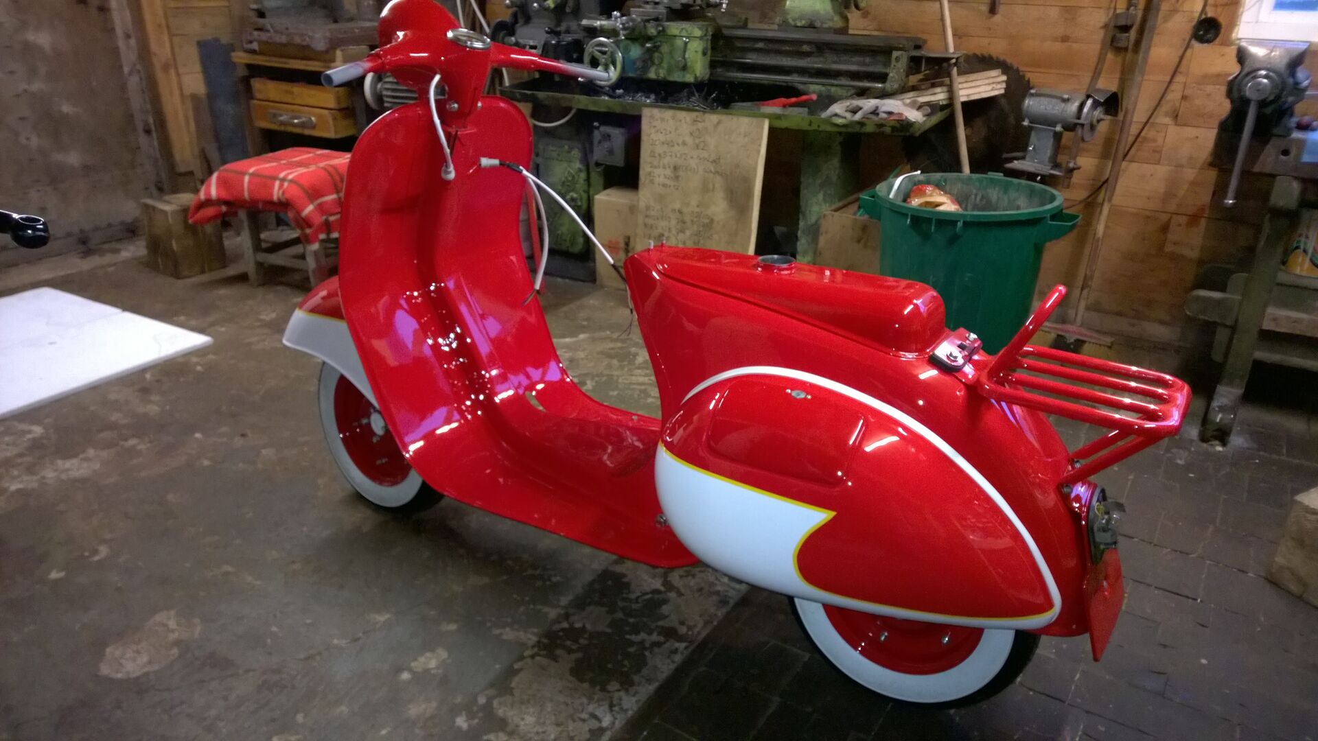

    And it is almost done. Only foot bands are missing (20.11.2014). Now it has an Estonian registration plate and local documents. Street legal machine. :)
    This was my third Vjatka. Last year i restored 1964 and 1973 year Vjatkas.

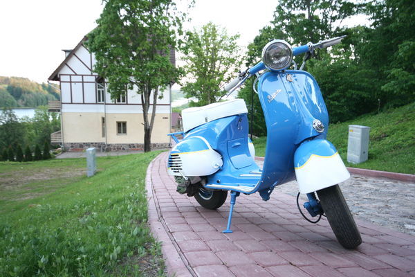

    Hello Mate
    Very nice job , how much do you have to pay normaly for such a Vjatka in Estonnia ? and how much was the paintwork

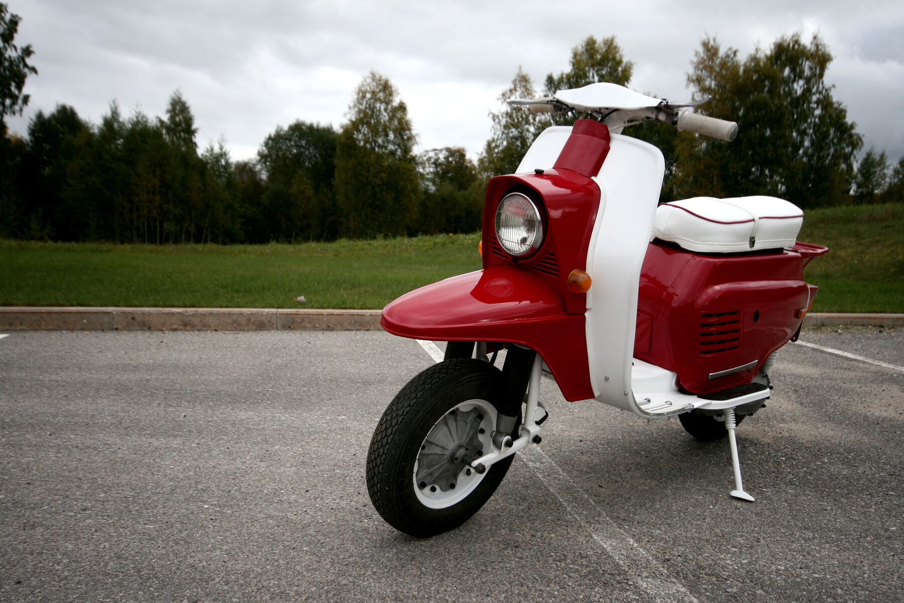

    What kind of Bike is the second red/white one --> the last picture
    Maybe , if you are from Tallinn , i see you and you Vjatka next summer when i´m vistiting Estonnia

    It´s the Christmas-Edition, isn´t it? :D

    Yes, this is Christmas edition Vjatka. ;)
    Paintwork with sandblasting was about 1000€. This restored scooter is for sale and will cost 3500€. If anyone wants it's own collections, i can help to transport it in the middle of Europe. This is not a problem.

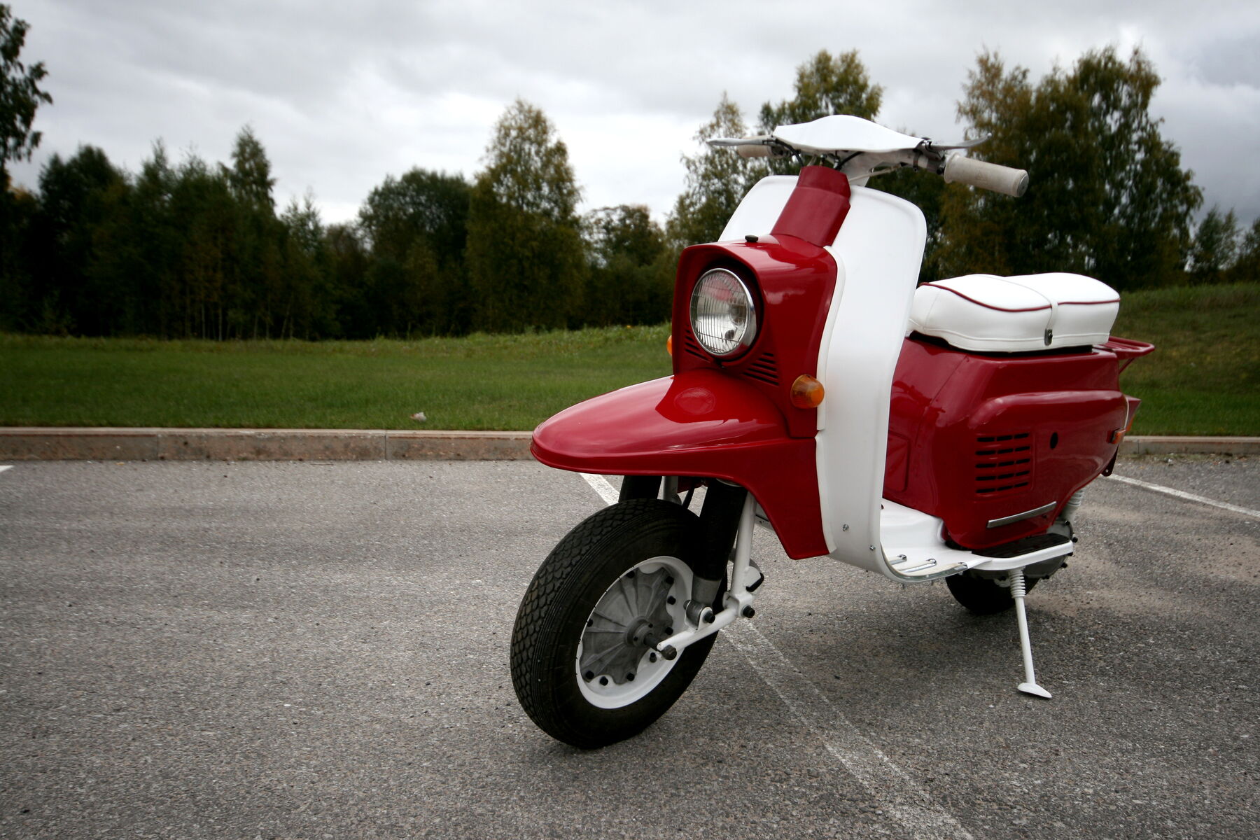

    1961 and 1964 scooters are Vjatka VPMZ (make) and VP-150 (model name). Vjatka VPMZ (make) and VP-150M (model name) is the last picture. It has same (148cc) engine, 3 gears but newer body.
    By the way, i live in south-Estonia, in the town called Viljandi. Estonia is so small that you can easy to come visit me and my scooters. 8)

    @Rally Vjatka W150M das Nachfolgemodell der Vespa - Kopie den russischen Verhältnissen angepasst mit mehr Bodenfreiheit, später dann auch
    mit elektronischer Zündung (electron)
    ab 1964 am Markt, ich würde mal sagen so eine Art Cosa halt ;)

    The W150M looks like a hybrid of Simson-scooters, MZ-bikes and Lambretta-scooters. Espacially the front with the headlight and the fender got the look of these scooters/bikes... very funny. :D

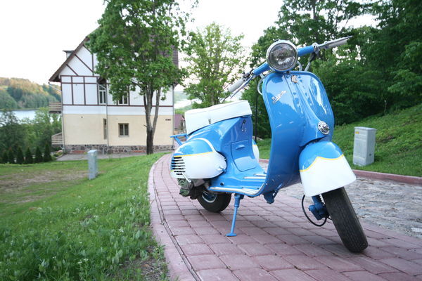

    do you have some other pictures from the blue one restauration.

    Btw, blue Vjatka restoration topic is here.

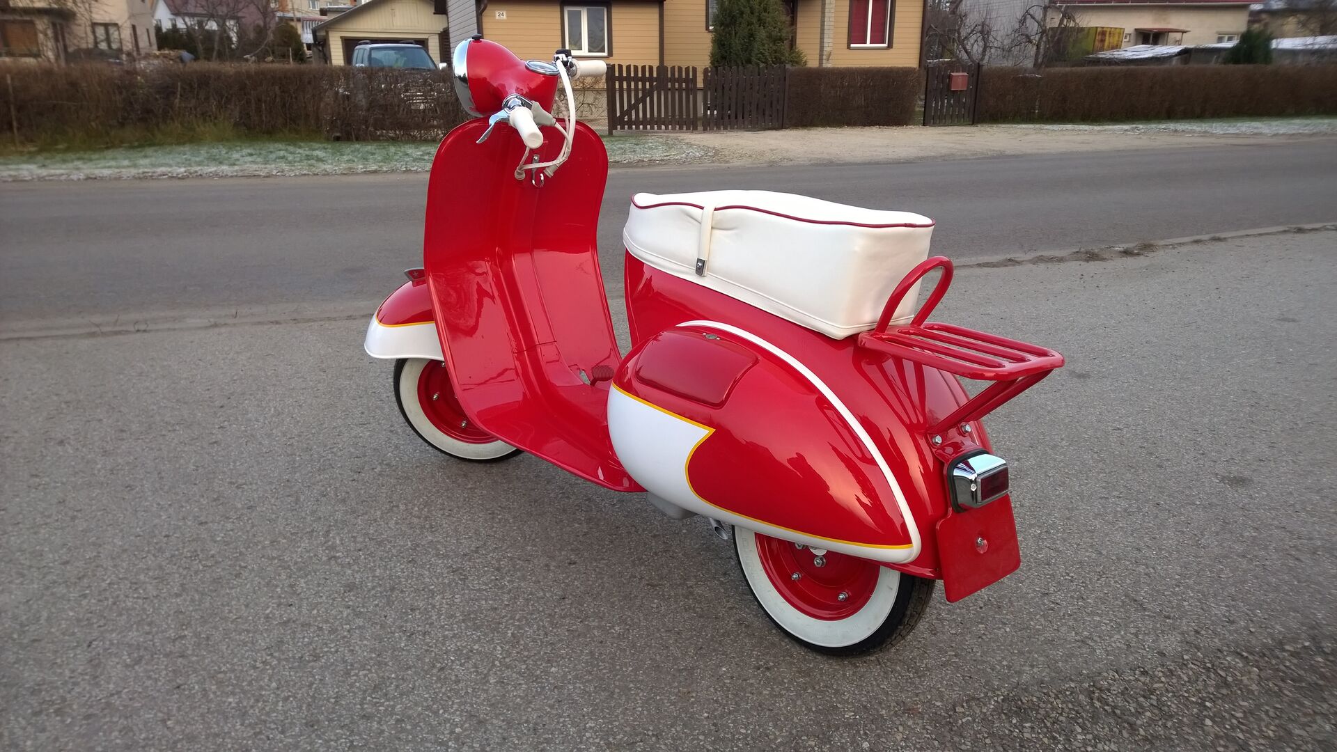

    • March 24, 2015 at 15:54

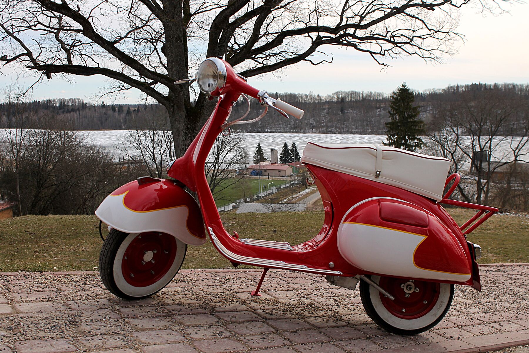

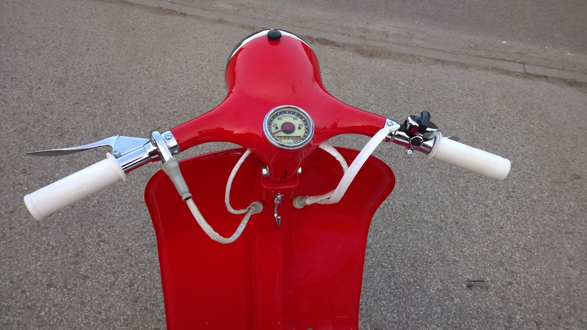

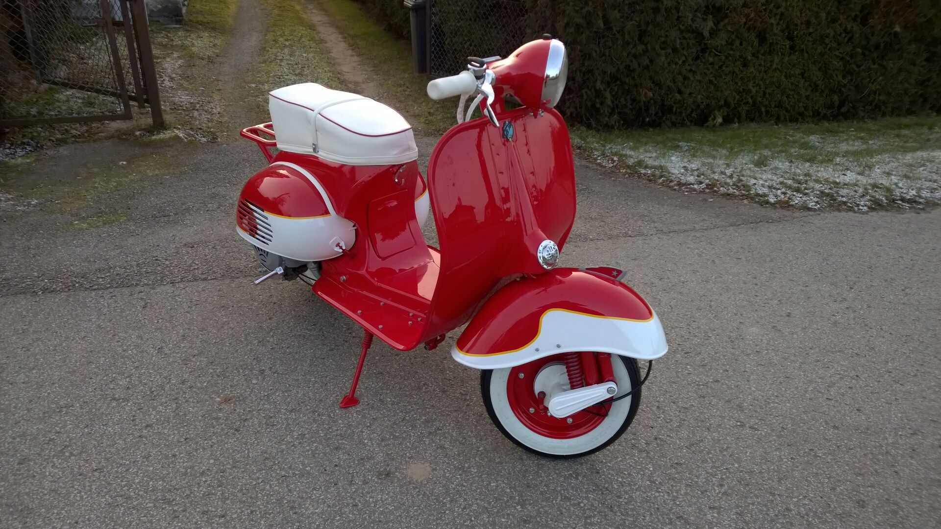

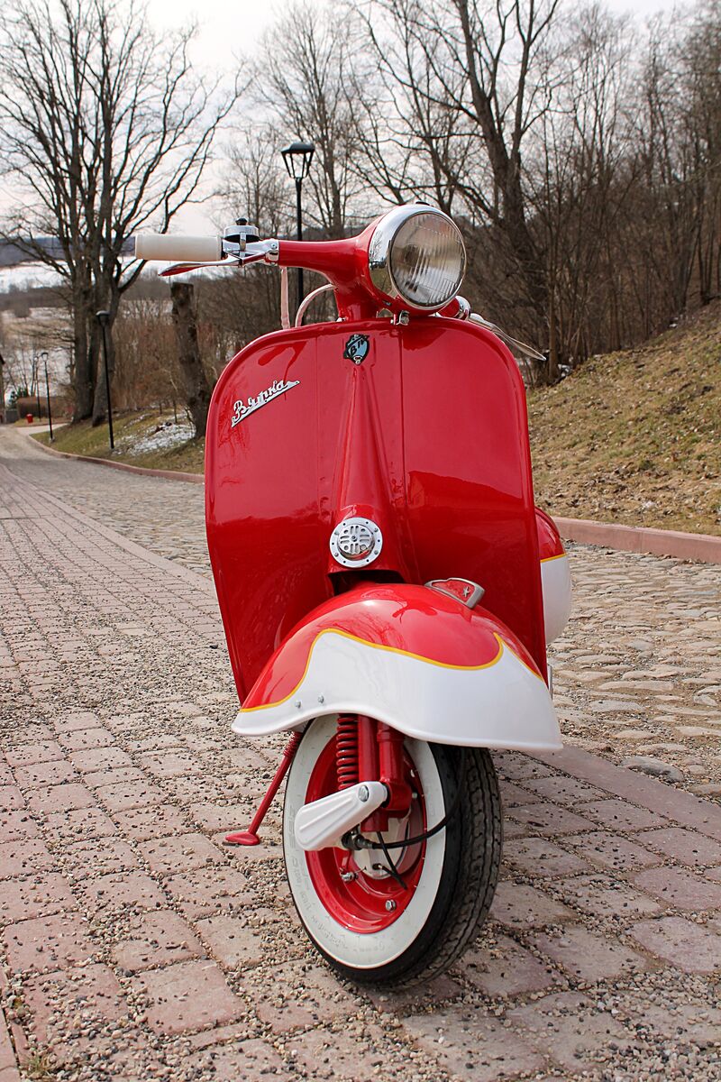

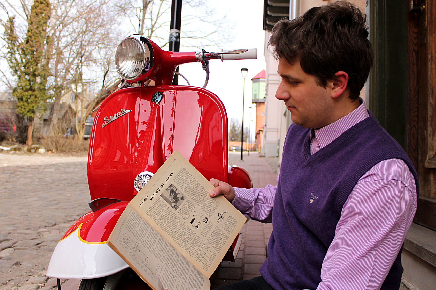

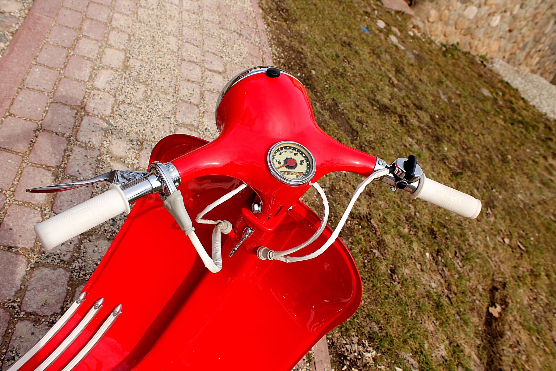

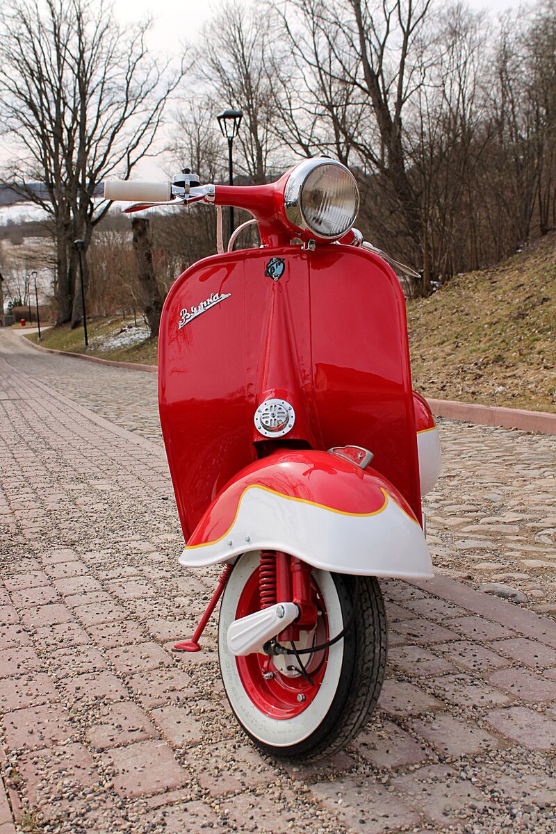

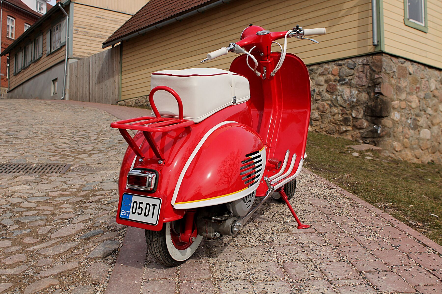

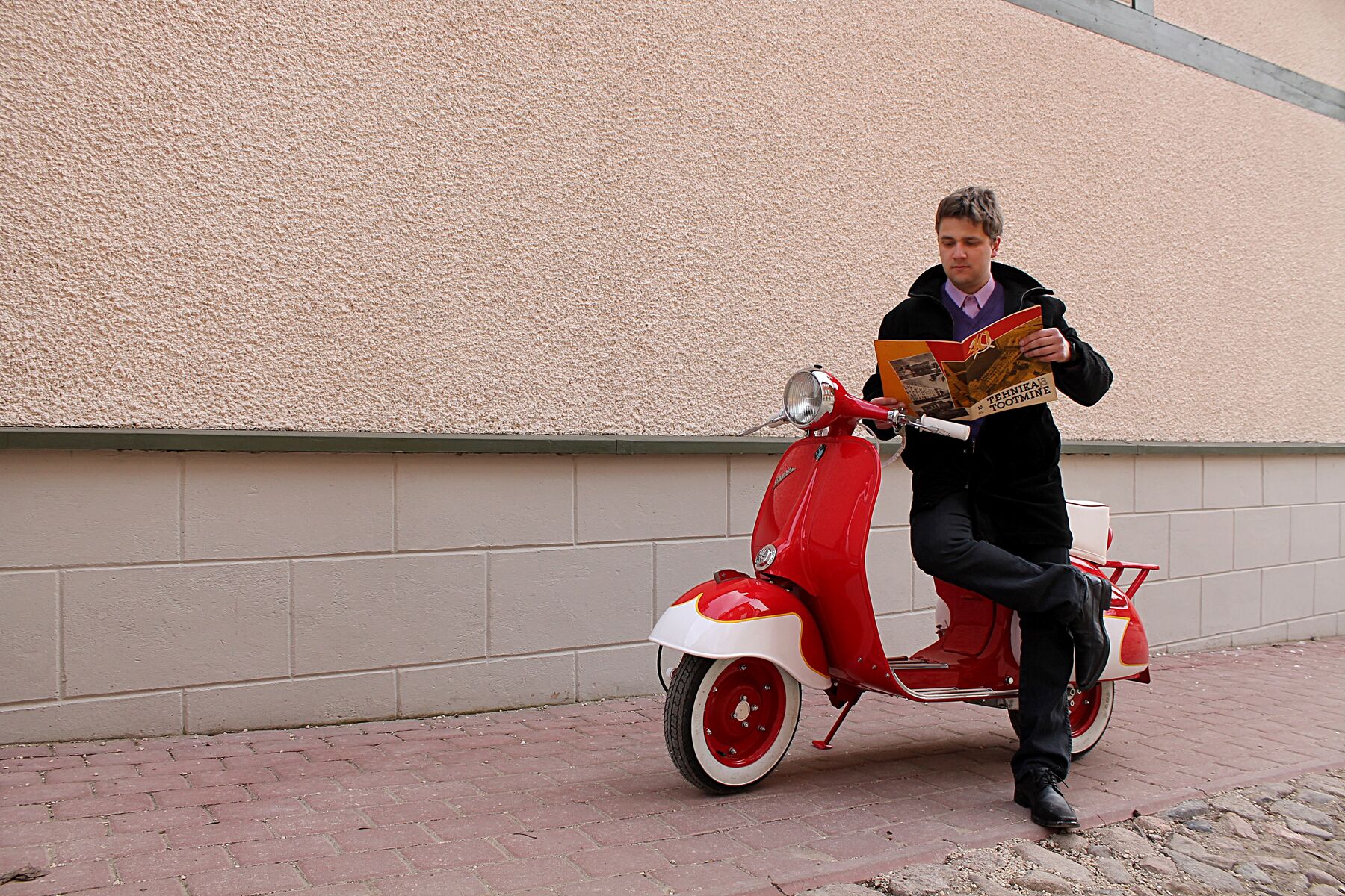

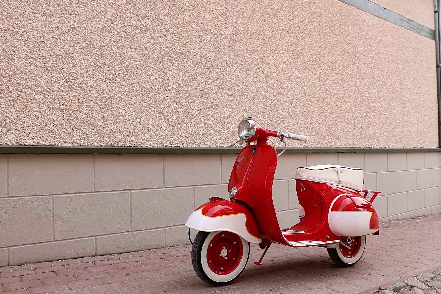

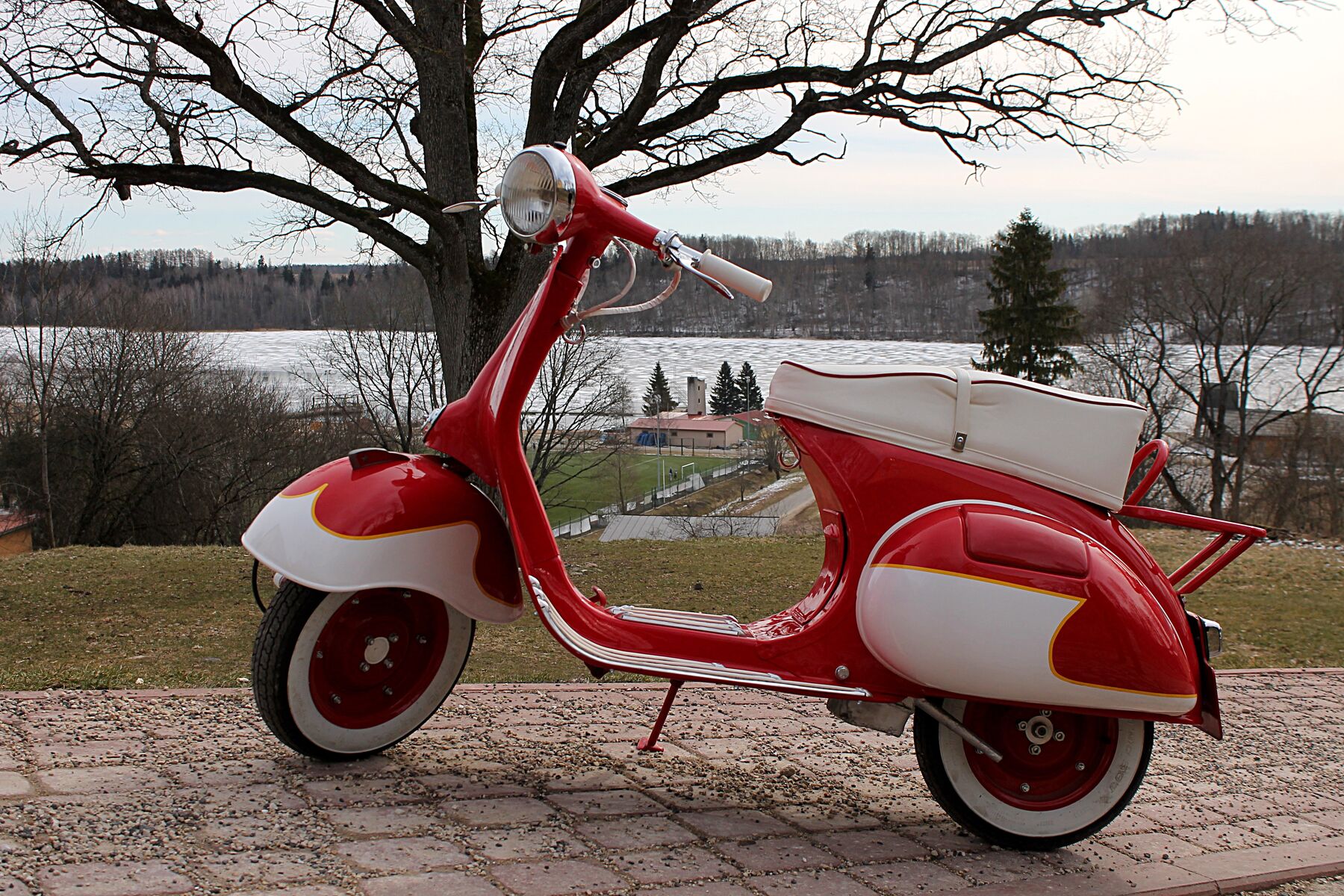

    Has been a long time of silence. Scooter is 100% done and a couple of days ago was a photoshooting. Weather was terrible cold (below 0 degrees) on that time, but last week was 15c and spring. Mystery.
    And me and my beauty. 8)

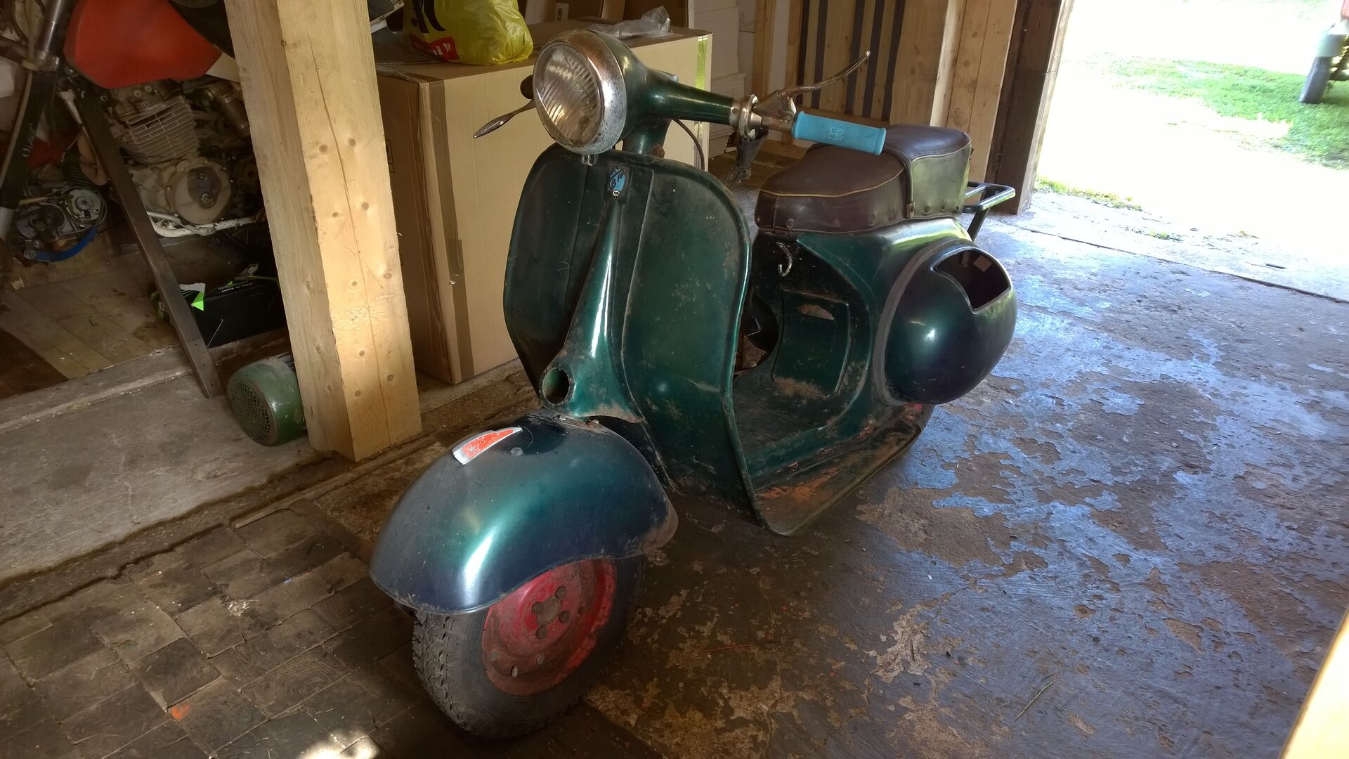

    A couple of months ago i got a Vjatka three-wheeler. Like this one, but mine is on a pieces. I know one more contact where i can get second complete scooter to build one of the two. These are very rear.
    Remind you, if anybody need some Vjatka parts, whole scooter, these tricycles or my restored Vjatka, please contact me, everything is for sale.
