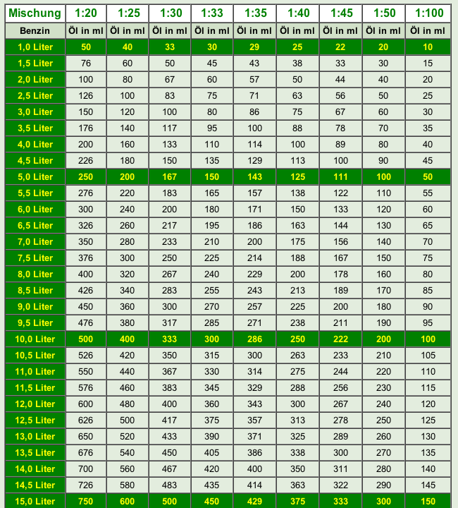

    • January 5, 2018 at 13:11
    Guckst du

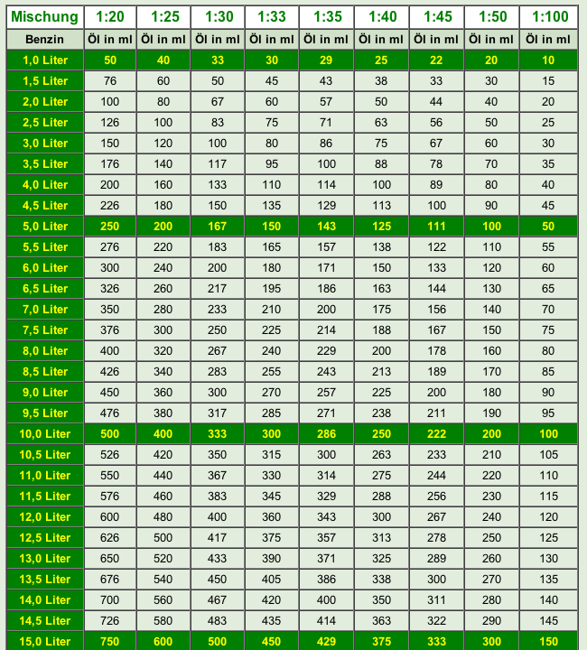

    • January 5, 2018 at 13:59
    Meine Lösung :-)
