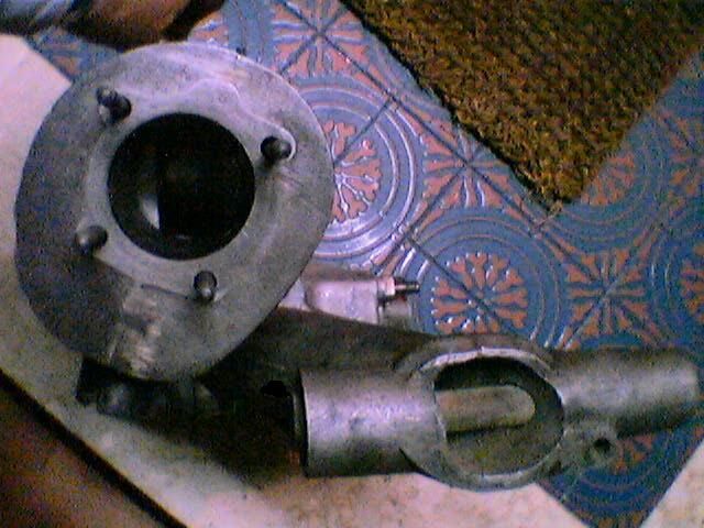

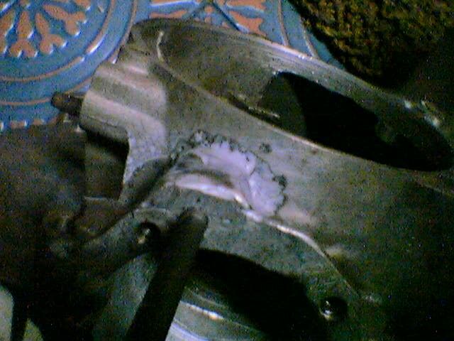

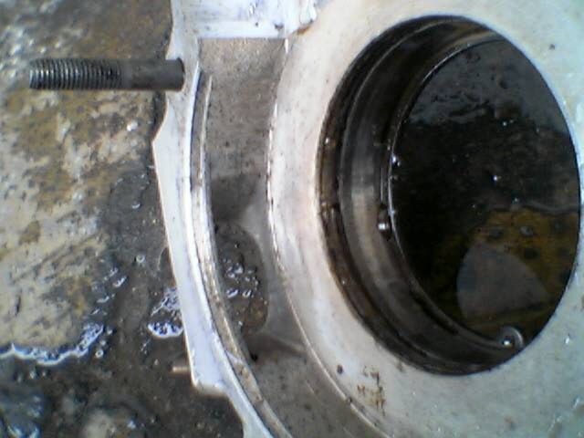

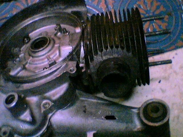

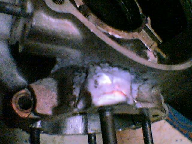

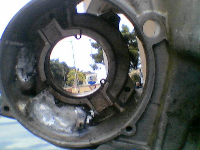

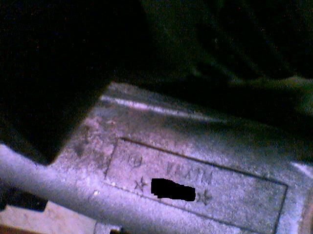

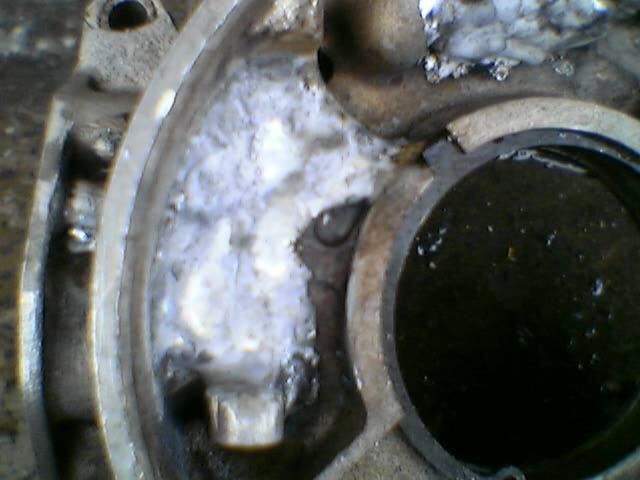

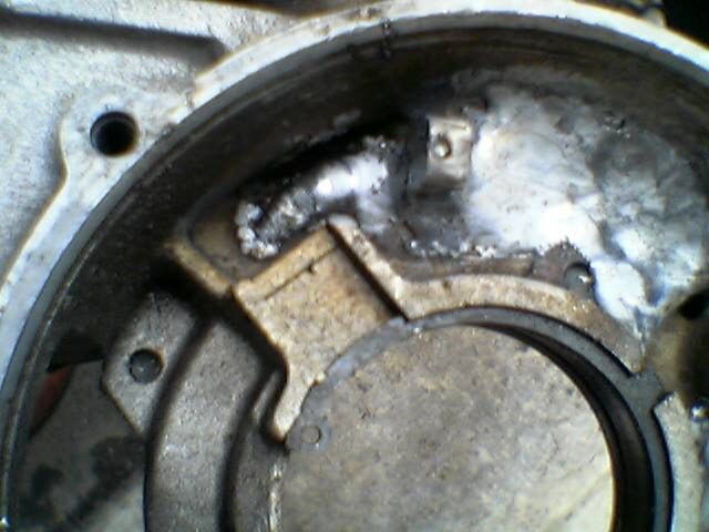

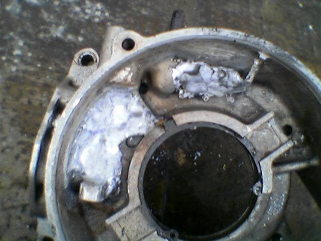

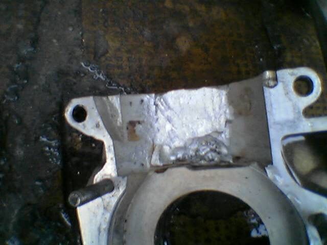

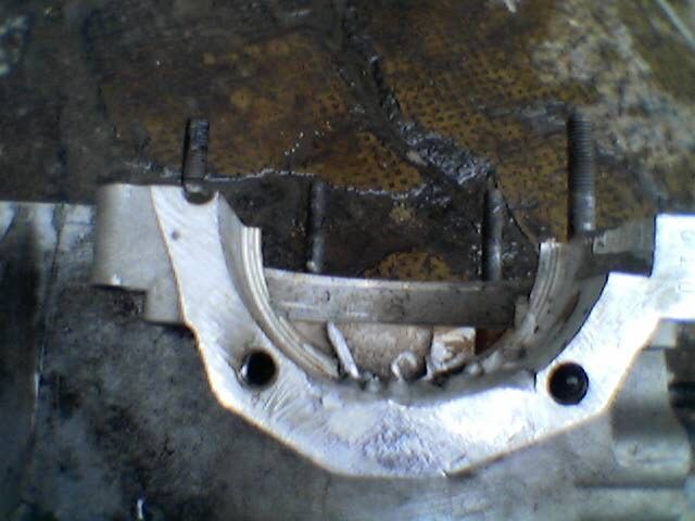

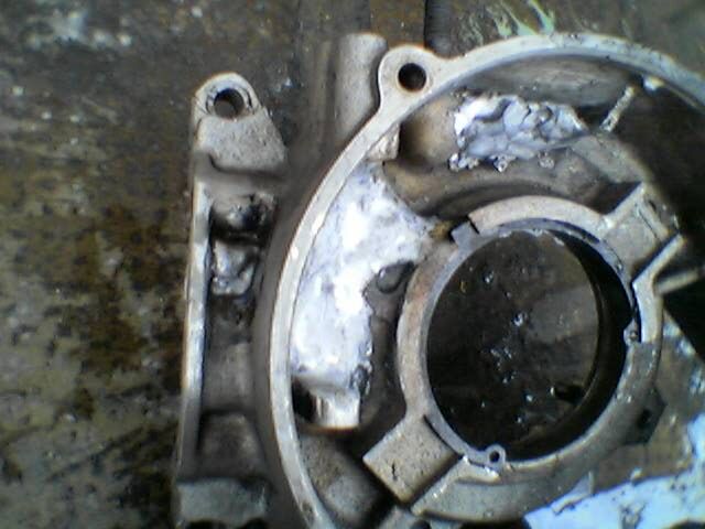

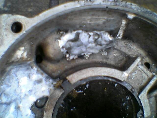

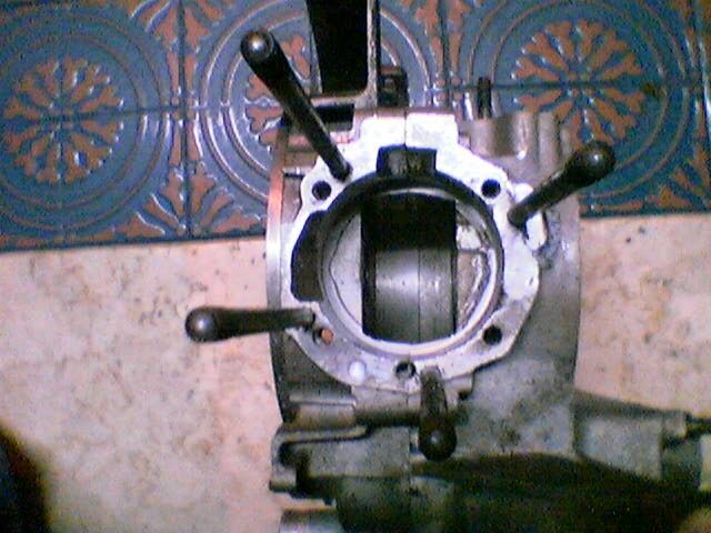

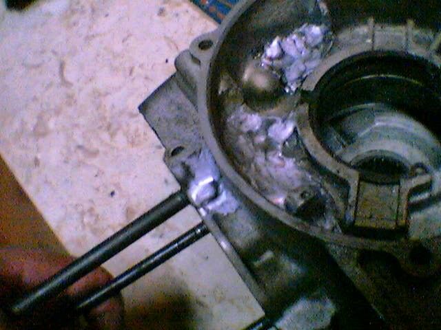

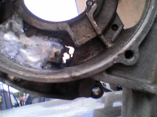

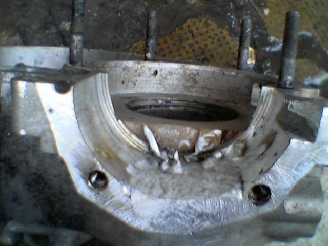

from 125 ccm to 200 ccm enginecases ...
other pictures ...
.. others again ...
so you can see starting from VNX enginecases now I can mount 200's cylinder (VSE).
I hope that I didn't understand what you wrote; I don't speak German, so if I misunderstood your message you can erase my pictures and please excuse me.

I think it should be easier, the main problem should be the inlet port (valvle), it's bigger and different in 200's enginecases.The crank:
in 125/150 is like in 200 in the right side, near the flywheel;
the other side, on the left, near the clutch, is different and I think you must keep the 200's side, it's larger than 125/150's side;
the conrod is different, 200's conrod is longer (110 mm) than 125/150's conrod (105 mm) and the piston's hole is bigger (200 --> 16 mm, 125/150 --> 15 mm).
SO you should mount a 125/150's conrod on the 200's cranck.Than you need something to adapt the bigger 200's hole for cylinder to the 125/150 cylinder, and put on it the new studs cylinder (in 200's engine are 4 x M8*160, in 125/150 4 studs M7*140); you must fix the adaptor in the enginecases.
So you could put a 125/150 ccm cylinder on 200's einginecases. You will have the inlet port (valvle) bigger than a 125/150's engine.
This is only my opinion, of course.

You actually really thought about that stuff, didn't you?
After all you pointed it should be easier to mount a complete 125ccm engine than to stuf it together. And that was what we were talking about, for there is no cylinder-kit fitting on the 200-engine! -

Thx 4 loading up your engineshoots.
Quiet interesting how mutch effort you took to fit in the Zylinder.
I prefer the KISS System cause I such a lazy fart
Iit seems you got acces 2 a Alloy Welding machine,you lucky bastard
Also I dont know how mutch a used 200ccm egngine would cost in South Italy
But even in Germany (recently around 350€) the prices are far to high.
Thats why I started 2 fit in Cosa engine in PX Frames.Cheers Ante
